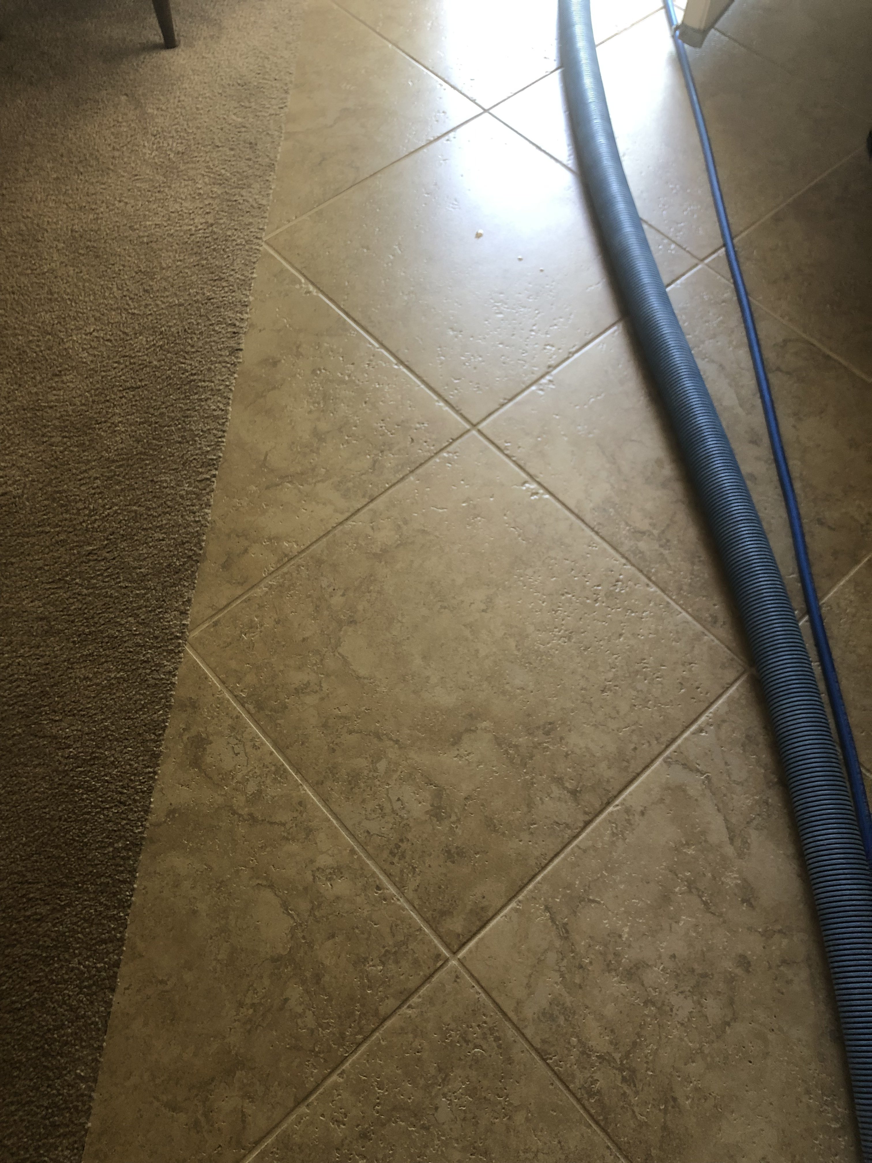

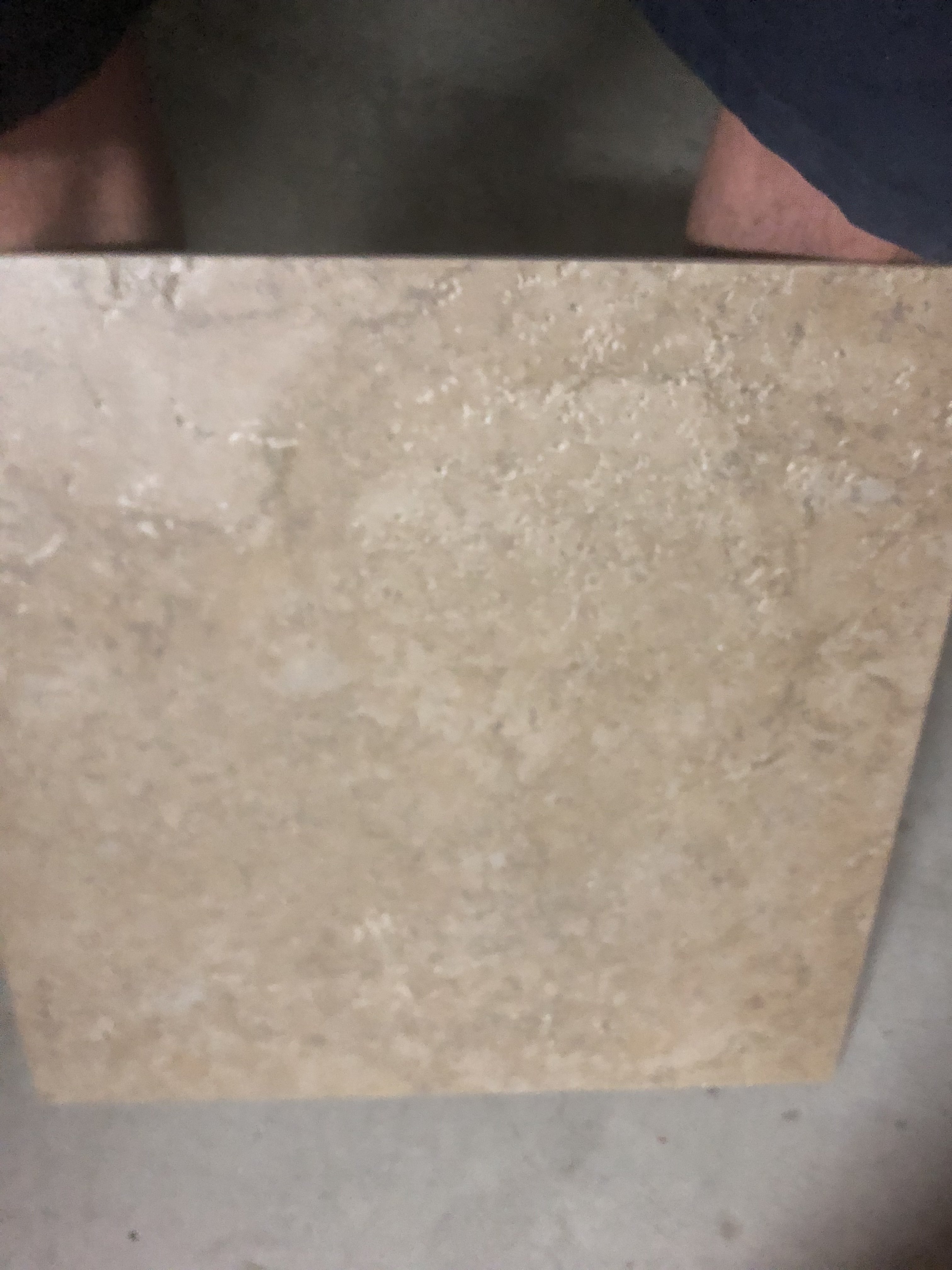

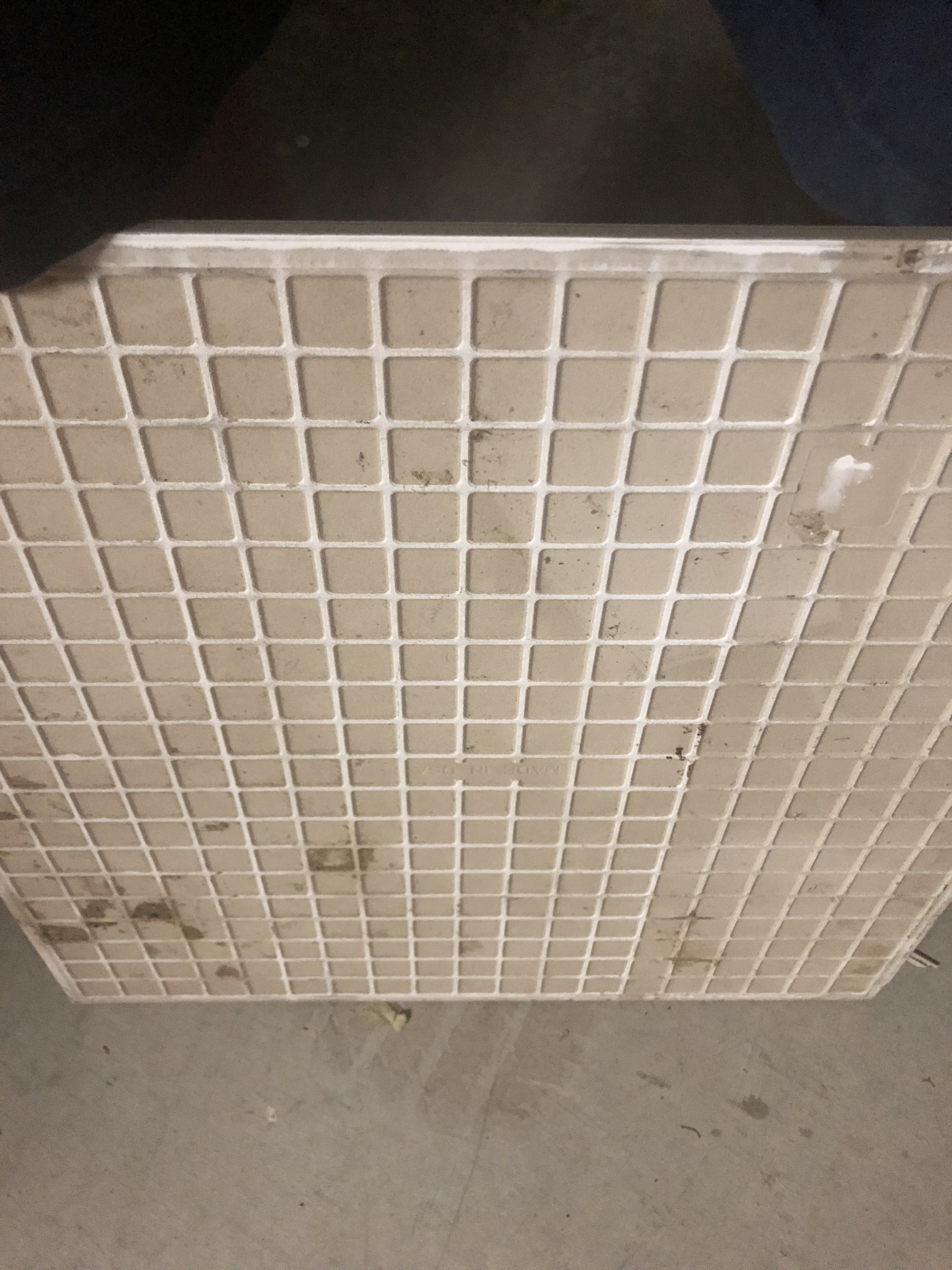

Lady said she had natural stone and paid 40k for the floors 500 sq ft.
Track housing. Pretty sure it was porcelain or ceramic. Either way paid way to much

I know it wasn’t real but she was super convinced she paid a ton to the builder and it was natural. If they did pay more they got robbed

I can tell its not real, how do you tell difference between ceramic and porcelain?

Like I said here I’m pretty sure it’s not real look at the back.
Sam
You really need to spend some time in tile stores, there should be no reason at this point in your career to be "pretty" sure about that tile.
The front is more of a give away than the back.

When I walked in and looked at it, I called my wife immediately and said stay home I don’t need my stone products for this. I didn’t have acid and the scratch test pretty much made sure it wasn’t natural. But when someone Insist you start to question and check
Most flooring contractors have 2-3yr warranty she should also get the roc involved
