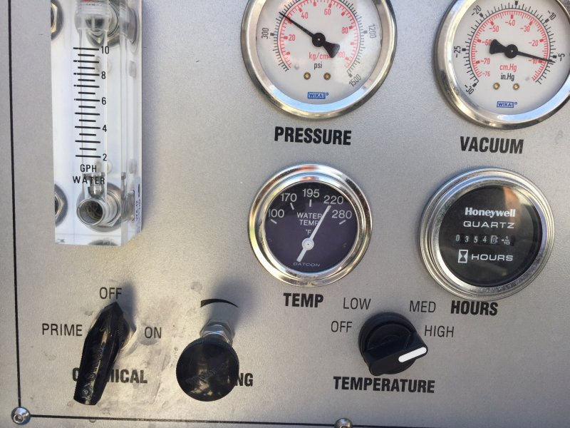

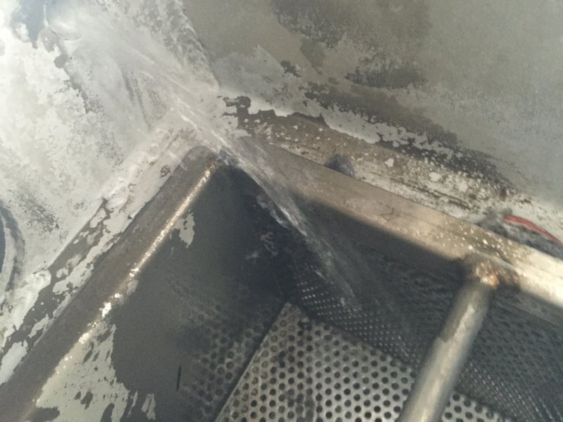

The machine holds reall good heat and cleans like mad, the issue with the temp switch is something i'll get fix when I can go to mitch. the uber bypassing was making me mad after fillling up after 400 sq ft of tile and 200 sq ft room. I notice the bypass was just running running running, and new a few people here had the same problem was hoping it was an easy fix. Hopefully Empire can tune it in and make it right.

Actually I said it closed the next morning! when the ambient temperature outside is cooler the machine doesnt get as hot and bypasses less when its 90 plus or hotter out and it runs for a while it cant bypass enough. thats my take on it.
The day it was bypassing like crazy was a warmer day!
