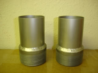

We have some 4" pipe fittings and some 3" pipe fittings . Also 3" Aluminum 90° bends.
3" & 4" SS. tubing. Here is some typical blower piping and flex connectors:

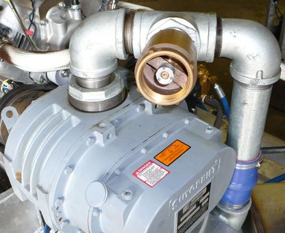

I'm assuming that those are 2.5" connectors.
Yes, pretty obvious when you put them side by side with 2", kinda tells a story.
To go along with your theory why don't you make them straight instead of a 90.
Like this?
If you look close on the TNT pictured, you will see that exact straight 2.5 nipple coming out of the blower, some TM mfgs. think they cost a bit much, but I wanted it super thin walled for maximum airflow.
You are right about the hard 90 on my machine. I can see it would be a little restrictive. I going to change the connection at the tank so I can clean my filters easier. It's starting to hurt my wrists twisting that hose back to get at them. That hard 90 will be gone.

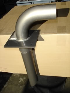

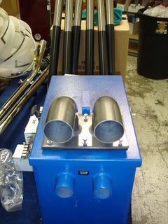

Here is the new filter box design.I'll post it in X-ray so you can see the inside. I went straight 4 and 2 .2.5's It should be an improvement.
