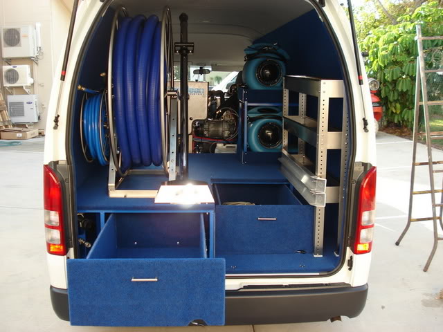

Here is the photo's I was talking about above with doors on both sides. When you mid mount your TM, it makes washing the waste tank out extremely easy as it mount directly behind the machine. You don't have to climb over anything to get to it. You can stand on the ground and reach right into the tank. And setting a machine up like this allows for great airflow, and everything is quite open and easy to service.
This is the largest van we have in Oz, before you upgrade to the larger Iveco, Ford, Mercedes vans (like picture a few replies above) and it has a bit of head room to utilize. So we made a suspended floor so the hose reel goes closer to the roof, and then it gives us the ability to put these drawers underneath the now raised floor to carry all the odds and ends.
With the drawers closed. You can also see some ramps affixed to the side of the stainless steel chemical shelf. Down the bottom right hand side you can see we have extended the vacuum and solution hook ups and ran it under the floor.
In the photo immediately above and below, we can carry 2 air movers on the right hand side in front of the chem shelf, and another 2 in front of the stainless steel vac hose reel.
And this is what the ramps are for. Either for wheeling up a dehum, Cimex, portable or whatever without busting your back.

Sweet set-up! That's what I'm talking about. I really dig the huge hatchback and that interior is tricked out.
royalblue
Nov 19, 2006
7
The van is the latest model Toyota Hiace SLWB (super long wheel base).
One of the more popular tradesman's workhorses in Australia. This model comes standard with sliding doors on each side.
