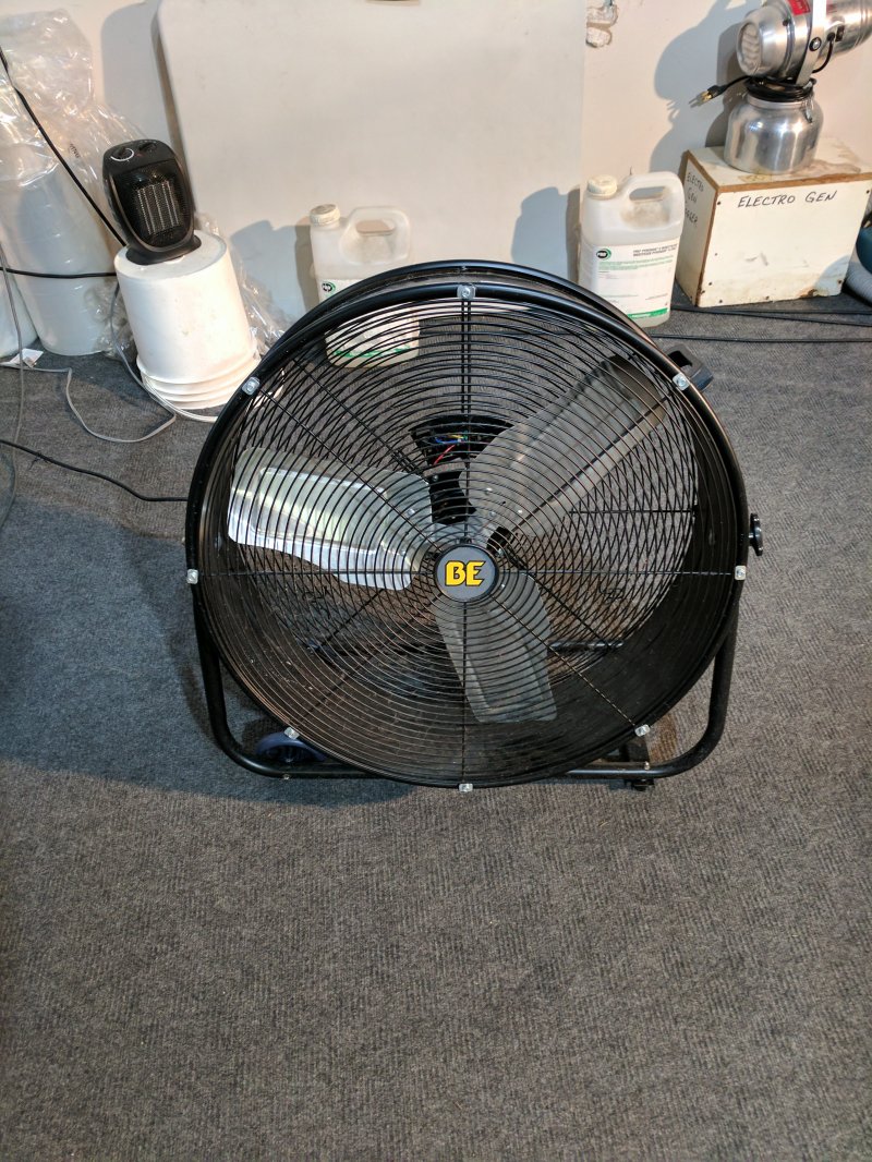

I am starting to use axial type fans instead of snail fans. I purchased a large 20 inch axial fan from a local pressure washing supplier to try it. $150. It works so well, I am going to buy several more. It is less pressure but over a much broader area. I usually get overnight drying with just one drieaz evolution dehu.
27,866
Here is a pic. It's actually 24 inches.

I'm looking to dry rugs that are hanging as well as laying flat with the least amount of energy consumption.
I would think both snail n axial fans are needed. Doesn't the snail fan flow the air over the top of the rug speed up evaporation of the rug on the floor? And are Axial fans better at drying out an air space/room?
I wonder if placing an axial fan on top of a dehu would increase airflow through the dehu giving it a better recovery rate?

You need a Studebaker.
Studebakers will work and you can use them for drying on a flat surface as well but pricey. I can buy 3 of these fans for the price of one Studebaker. Nice thing with these fans is that one fan dries 2 poles. Doesn't blow the rugs off the pole either
