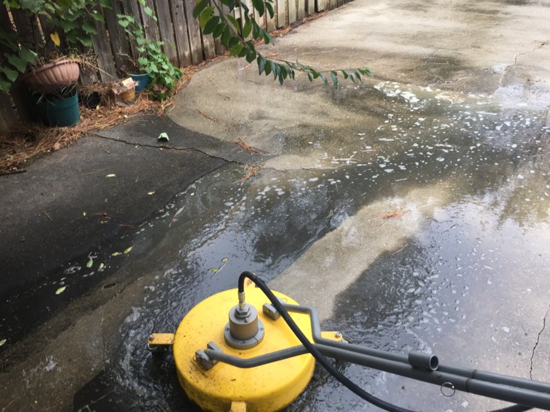

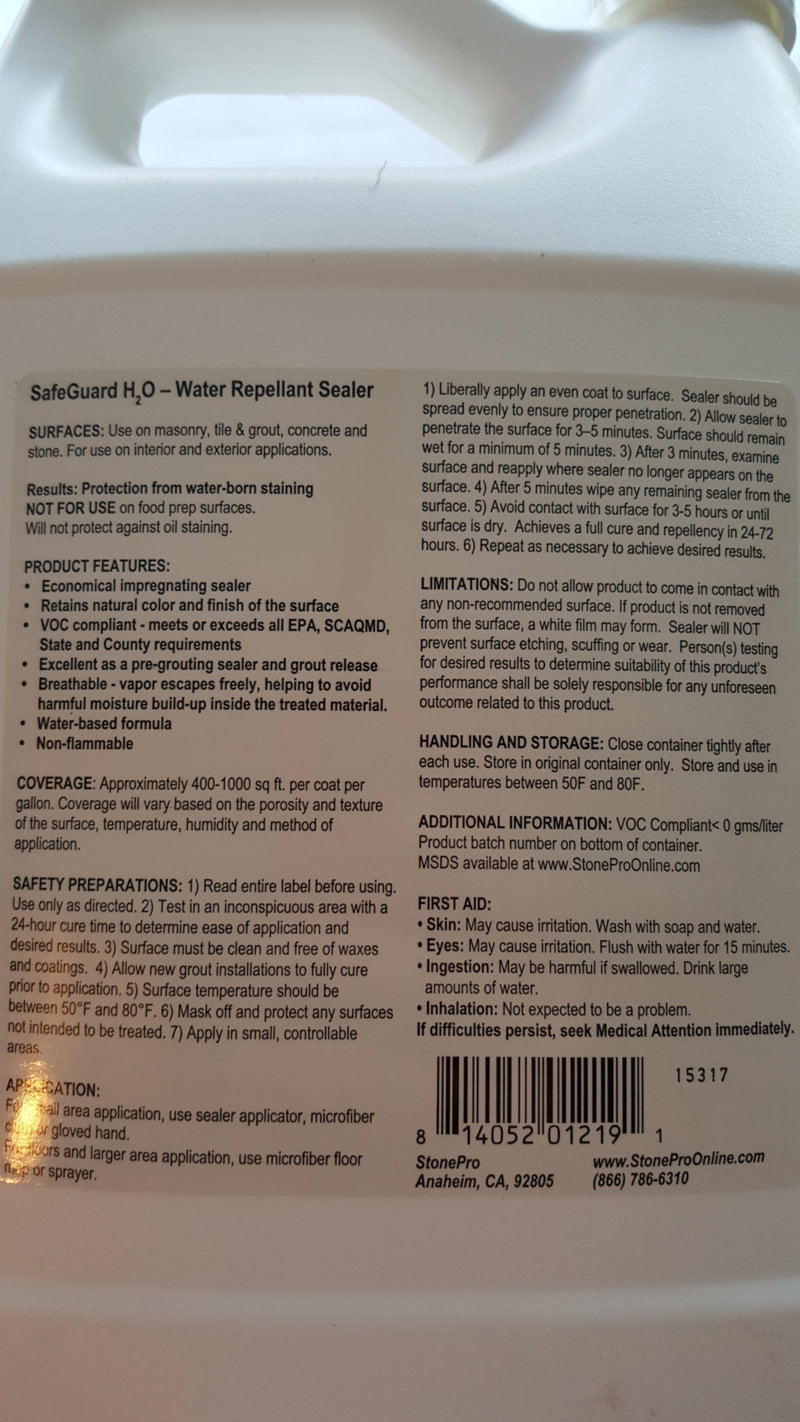

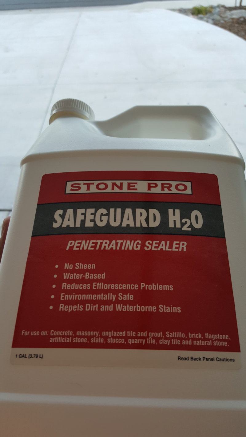

I tried a popular solvent based that did less than zero to seal my drive way..
This suff on the other hand..

We used several cases of Cobbs ultra seal the other day to seal some fake stone walls and wanted to see what it did on the concrete so I applied a couple of coats to a couple of areas of the concrete.
It did the same as your super scientific test did results wise.
After repeated dousings with water the water eventually started seaping into the concrete, so not water proof but very resistant.
They commented as how they could see it resisting while it was raining.
