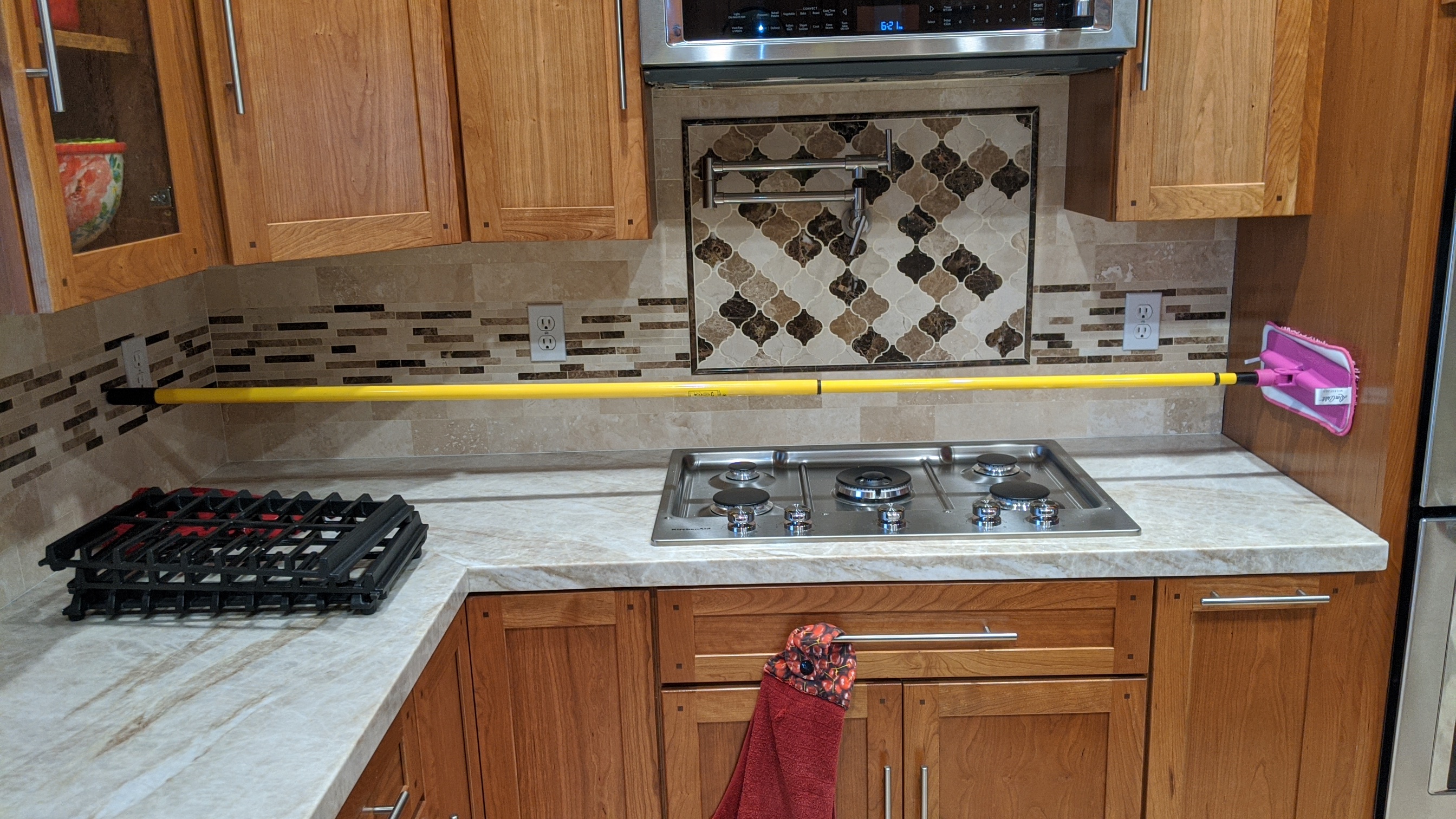

3 counters, 2 rooms, 16 holes, one tube surround joint...no sowers, for once.
