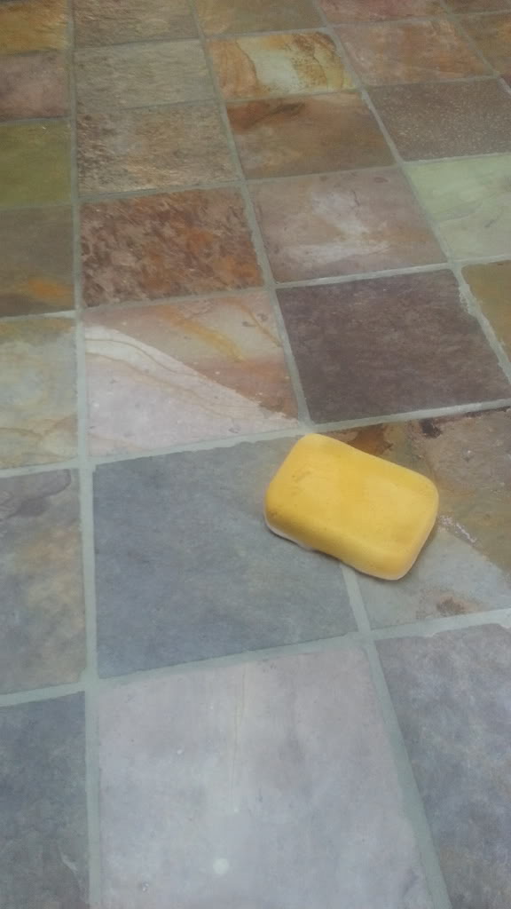

116,966
here we are applying a topical (shiny) sealer to some slate that we stripped on Monday..
116,966
How is is different than the $32 Glaze N Seal or $16 Jasco acrylic~water base topicals?
116,966
btw , when you strip Slate that has 4 coats of Glaze N Seal applied 3 years apart with only a hand washing, the living room turns into Lake Erie with a Malgrit brush..
116,966
Combines a Fluorochemical Protector with an Acrylic Gloss Enhancer
I guess that answers my question..
