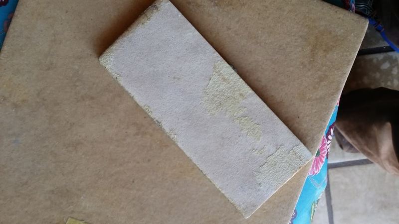

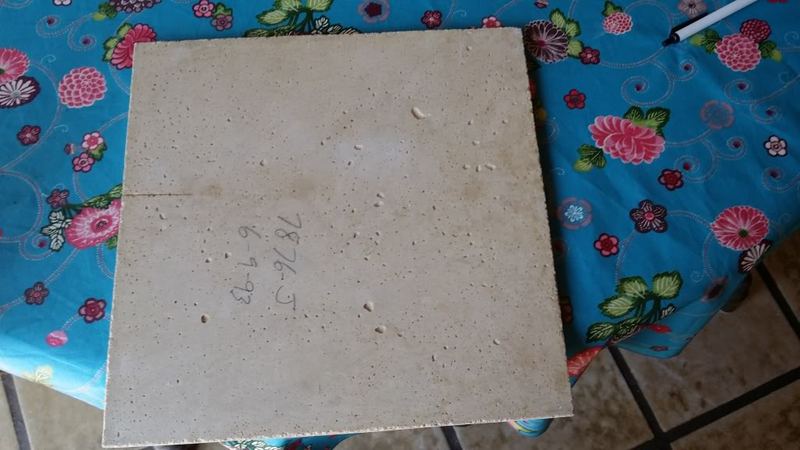

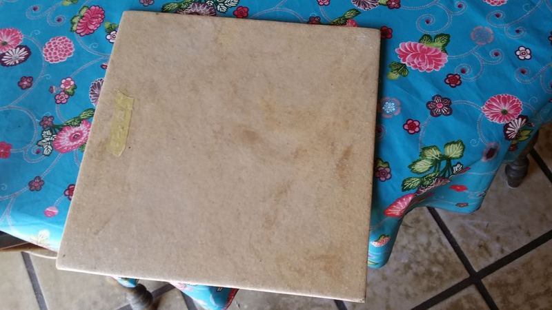

A couple have a floor of this stuff (her father owned the Terra Stone company) that's layered with Glaze N Seal water based finish. Loads of dirt between the layers..
top
bottom
Here the owner used a Gel Stripper on a small test peice and it took off the factory top coat
any horror stories?
