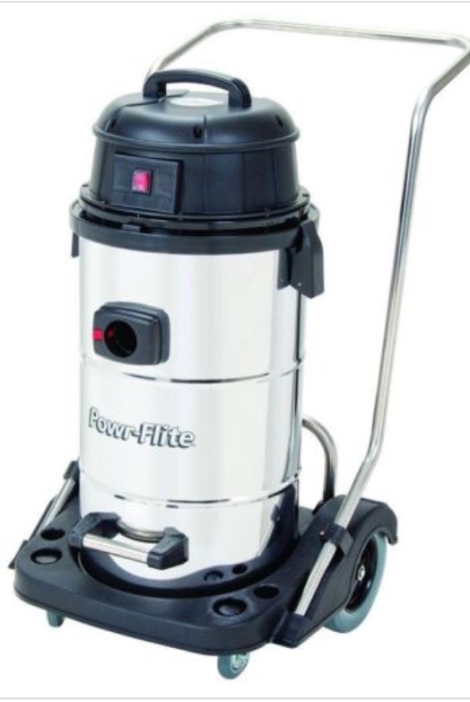

We also mop at the end so there is no streaking with a fiber mop and CHS all purpose cleaner. I know a wet vac sounds ghetto but it's easy to load. We also bring this if we don't have to go upstairs. Power flite can suck!
