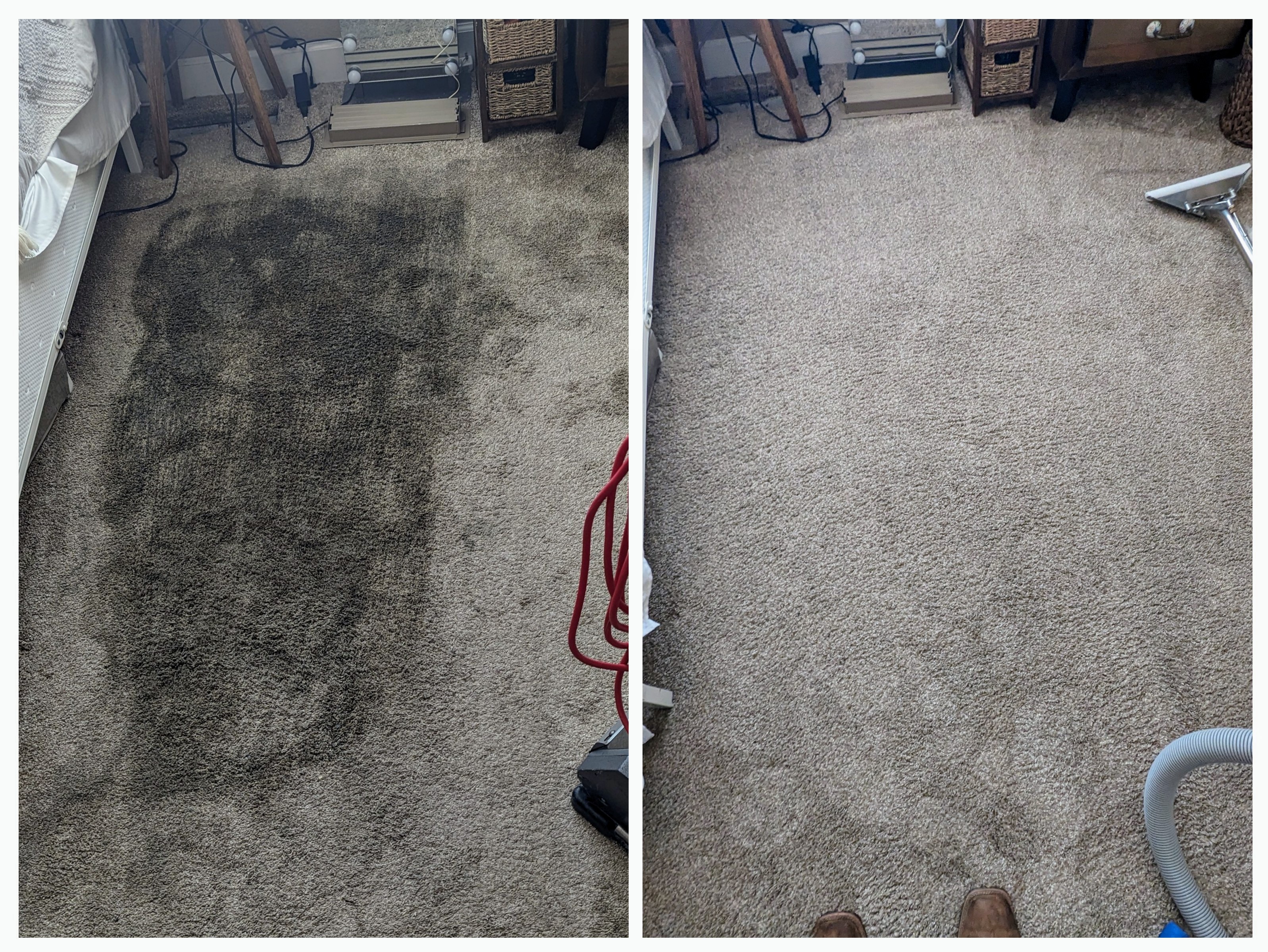

Now I used the Hybrid Greenglide for the first time on the PCQJ. The best just got better. OMG, the vac, the slight sheering sensati0n,on this tough dense cut pile, instantly dry.
Never thought it could be so easy.

today. dry to the touch by the time I left. Did this first then 5 bedrooms.
