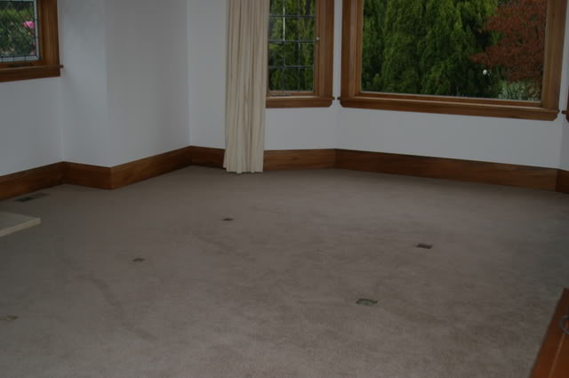

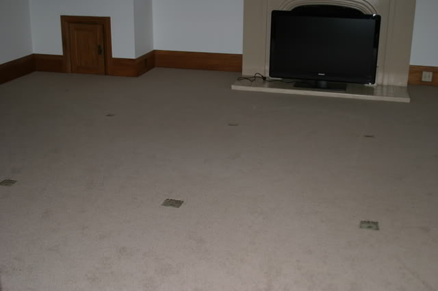

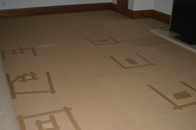

Unfortunately I didn't get to see this custom baby, but my client bought the home and it was listed as a chattel and came with the sael.
She decided that she needed a theatre room instead of a billiard room in her home. This home is upwards of 4300 sq ft.

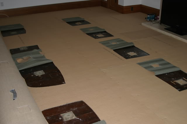

It took 4 guys a full day to dismantle and remove the table, however this is what she found to her dismay... the floor needed levelling and reinforcing for the weight and so the previous owners had sunk 8 new timber piles into concrete and brought them up through the existing floor and carpeted around the legs.
Using my belt sander, I sanded the piles back to level.
Relayed the pad and added more where needed and taped it.
3.5 hours, $600 and she said, 'is that all'? :cry:
John :wink:

Did you take any photos of your work in progress?
How did you cut the carpeting to match the holes? Did you recut the holes to where they were all uniform in size before you cut your donors?

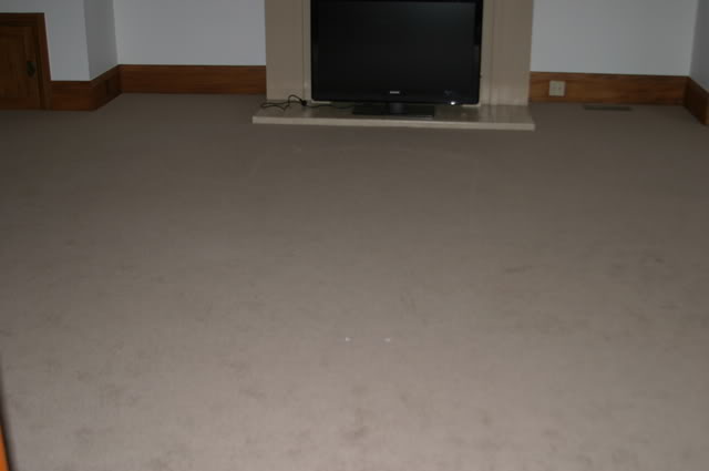

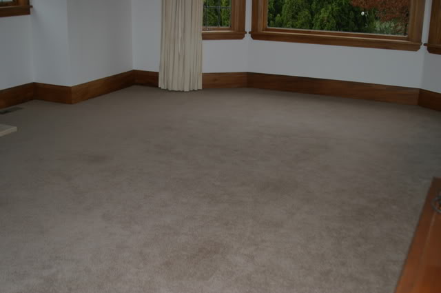

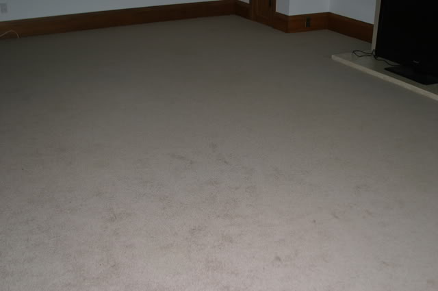

Just the photos there Kris.
I free hand cut all my repairs without templates.
She had heaps of offcuts (new) in the attis. I got a section and cut a strip with the row cutter just 1/2" over the widest section.
I then approached each hole in this manner. Awl to seperate the rows either side, cushion cutter set to just cut through the two backings run up each side taking care to cut the indentical width of my donor strip.
Once I had the two sides cut (approx 1" longer than the repair I intended to make) I then again ran my awl through the cross gaps to open the tufts up, then I used my duckbills to cut the ends. I simply did the same on the donor, measuring the new one off the piece I had cut out.
It was just a matter then of inserting KG tape and putting the new piece in.
I did all 8 like this before I warmed up my glue gun and plugged my KG in.
Then it was a simple matter of hot melt sealing two sides, bed it in, the other two sides, bed them in then weld twice with the KG. (two strips of KG tape per repair)
I hope that answers your questions.
