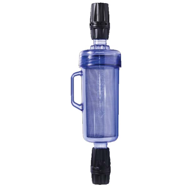

This is what I use with the stainless screen .. I was asking if 2 before the tank would be better than using the one plus the use of a blower filter - to create more vac pressure in the tank.

We use one that looks like the one in the pic, but it has a hinge on it. What are those black things on the top and bottom?

One of those pool filters is way more restrictive then any blower filter (at least on Prochem tm's)should be.. I run filter less EXCEPT for the blower filter. My vac is always the best it can be..
