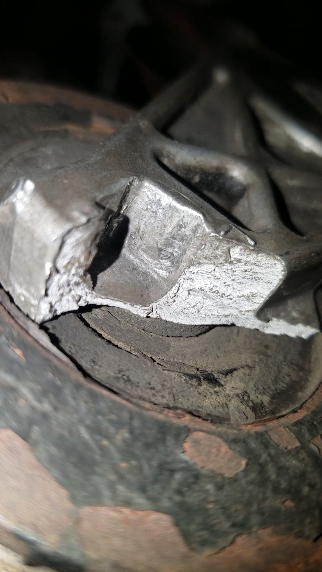

So I get the driveshaft installed and go to put on the new belts and among the endless other things the previous owner screwed up on the tensioner for the belts is sheared off and now I don't know how I'm supposed to get the new belts on.
