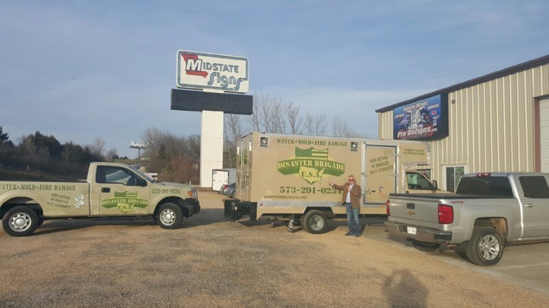

What type of box truck?
Brand? Weight?
Any pics?

Mark the Brand is Chevy. I'm not sure about the weight.

For equipment, I think you can go with just about any unit in there.
I would guess with employees, you are probably going to lean towards a heat exchanger type unit and anything with a 45-47 type blower.
Looking at that truck I am pretty sure you can have a Butler installed in it and I would guess maybe even the Sapphire Scientific pro 1200 SE... Kind of guess on the Sapphire but know Butler has put in that type of Box truck.
Also a lot of slide ins out there that would work too with a heat exchanger and be good set up too.
I do like a direct drive because one less motor to maintain but that would come down to your comfort zone.
If you were to consider a Butler I would get the larger blower and high heat package. And the 210 waste tank is nice especially in a box truck.
Chavez of course runs box trucks too and could give input on if a Butler or such would be good for you.
