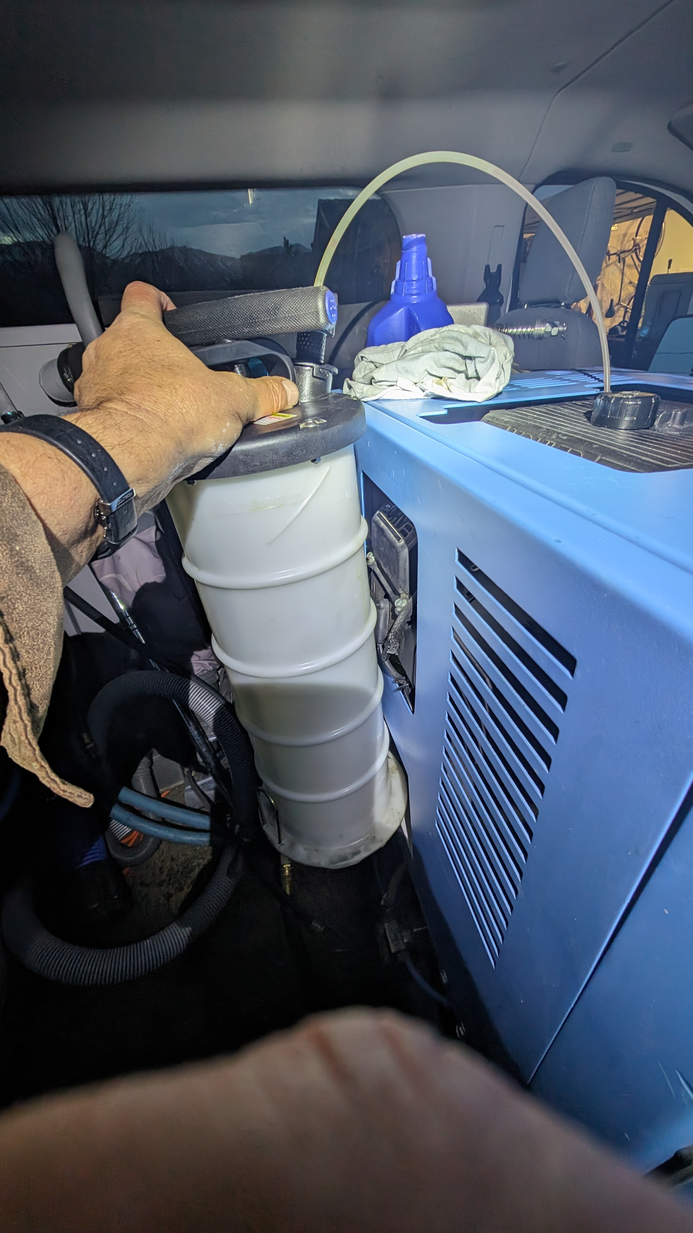

We did use an air compressed tool to help remove as much as possible and I believe the TM mechanics would do no different. I'm not running this at load or on a job yet& If I do this over again to clear doubt I should probably park on a hill like I do when I change engine oil 🤔

The exchange rate here of old Aeon oil vs New Aeon oil doesn't inspire confidence. Here we are as glorified vac cleaners and there's no vac attachment to extract...
Hold my bubbly water:
