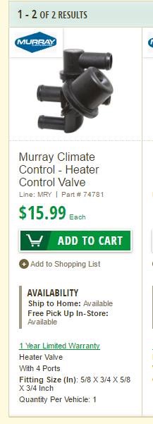

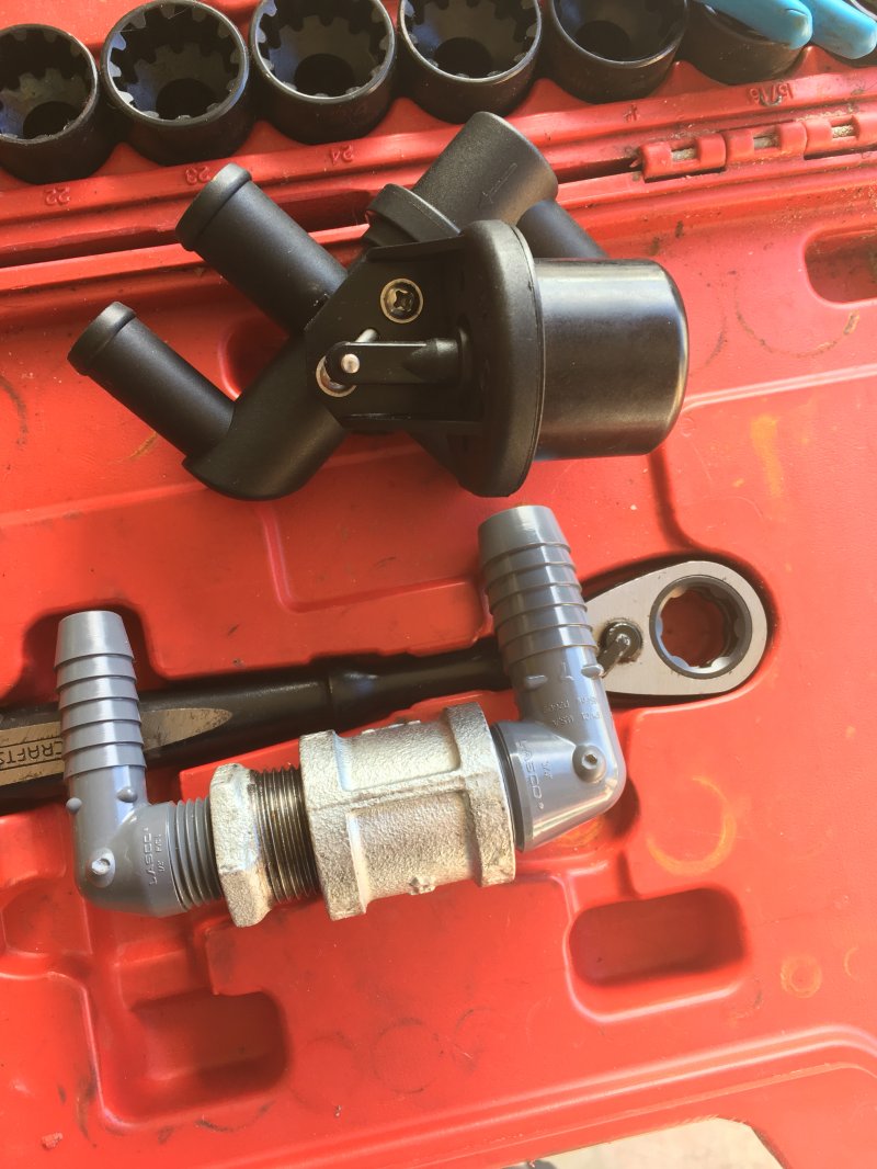

Finished first job and noticed the smell of antifreeze and that my engine temp was higher than normal. I immediately put water in my radiator using my ss870 to pump water from the water box. I noticed my heater core was puking out the water. Turns out it's a $16 plastic part that busted. The heater control valve. I'm off to the store now to buy one and hopefully get back to work. Excuse the dirty shirt in the picture. I was scuba diving in hot radiator water trying to find my leak.

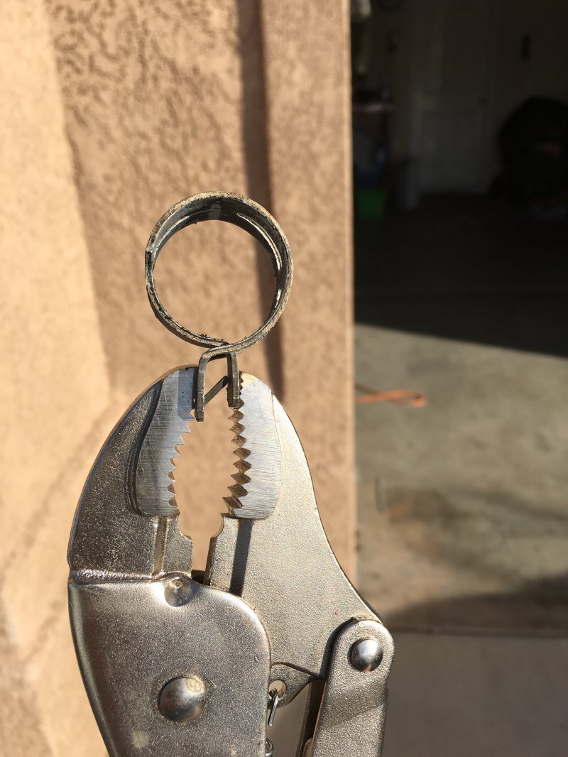

I'm living the dream. I can't get my hand in there to get the clamps off the broken bypass. so i'm just going to plug things up until I can get some cable pliers for clamps. I don't need heat. I can wear a jacket.

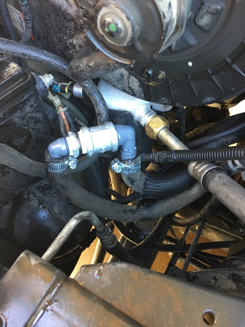

I can't get the damn bypass off so I made a Marty-Rig ( @hogjowl )bypass until I can locate some hose clamp pliers.
