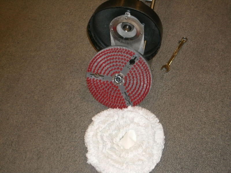

I'm going with a 175 from cleanfreak. I'm gonna get the carpet shampoo brush and a hard surface brush for tile but my only question (I'm sure I'll pay for this) is , do I wand the pad driver or the bristle pad driver for bonnet cleaning. This is a new process for me. I'm not sure about bonnet cleaning/encapsulation. Ive seen it done and get the gist, spray, bonnet and vacuum. Not sure I'll ever use the red scrub pads. I would love to offer an array of services.
Get the bristle pad driver as opposed to the black ones with the spikes. You will use this driver with all bonnets and pads. You can get red\white scrub pads at HD. Some guys prefer them to the brushes, especially on commercial, but decide for yourself. A lot of different style bonnets you can play with......microfiber, cotton, scrubbie strips.
Be sure the shower solution feed tank also.

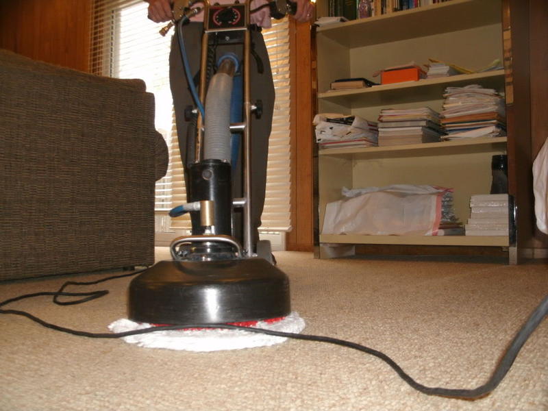

Straight encapping is purely scrubbing the solution into the carpet, usually with a white pad/red pad , and relying on the encapsulating properties of the solution and the post-vacuuming for the removal of the soil .......in theory. This is mainly considered a commercial "maintenance" technique due to the perceived limitations in it handling heavier soil loads.
In bonnet cleaning (pad-capping), instead of a non-absorbent scrub pad being used, the bonnets have the ability to actually absorb soils from the carpet, so you get more bulk soil removal as well as the residual encapsulating properties of the solution. It is needed to flip sides or change to new pads as they become "full" with soil, so in effect, there is more soil being "extracted" with this method.
They can also be used in combination.....like straight encapping an entire office, then running over the traffic lanes with absorbent bonnets to remove more soil.
Then there are combo pads made of absorbent materials AND scrub strips that are great for touching up areas after HWE, as well as many other groovy pads to play with.
A lot of different things can be done with that one machine.
