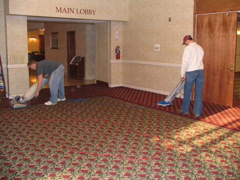

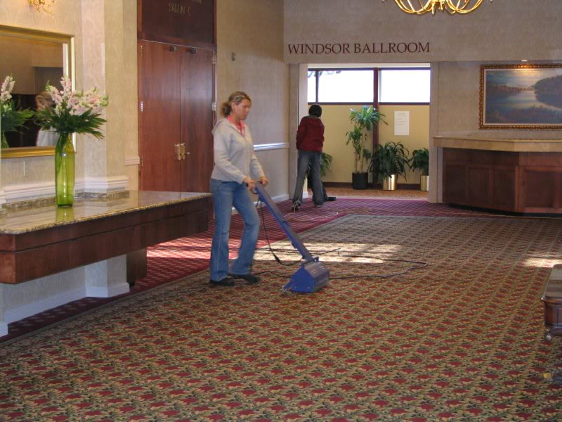

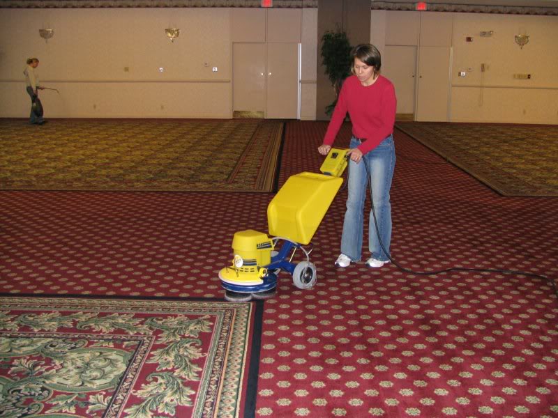

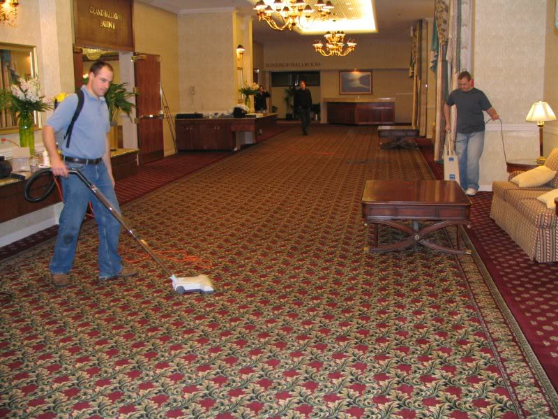

I always pile brush and vacuum first, this removes a lot of soil. As for drying times if you need to vacuum after, airmovers will allow it to be ready to vacuum within one to two hours. We almost always vac after but there is very little picked up especially when compared with the pile brush and vacuum first.
Here area a few pictures to show the pilebrushing followed by vacuum before encap; then encap; then post vac. So easy even girls can do this work! (just kidding, just a joke)

Where are your "professional" uniforms?
The PREVAC is the real cleaning step in the SHAMPOO process.
The "Crystals" are nothing more than a fine dust in the diluted stage.
So the initial prevac is the most important step if you want to say you did any actual cleaning.
Those advertising pics of dried residue in a petry dish are from the concentrate right out of the bottle.
Since there is no EnCApSULaTION method research the SHAMPOO method.
Nothing more, nothing less.
Also look into a bonnet cleaning for production and actual removal of soil.

uniforms?
Jimmy that was my first thought as well, Where's the uniforms?
They look like a good cleaning crew and have the right equipment but they are leaving out a very important step in how they project their company image.
It looks like they are in a nice hotel and who knows what new contacts can be made there. I so surprised that there are so many companies out there that are leaving out the basic steps on making their company shine and look professional.
