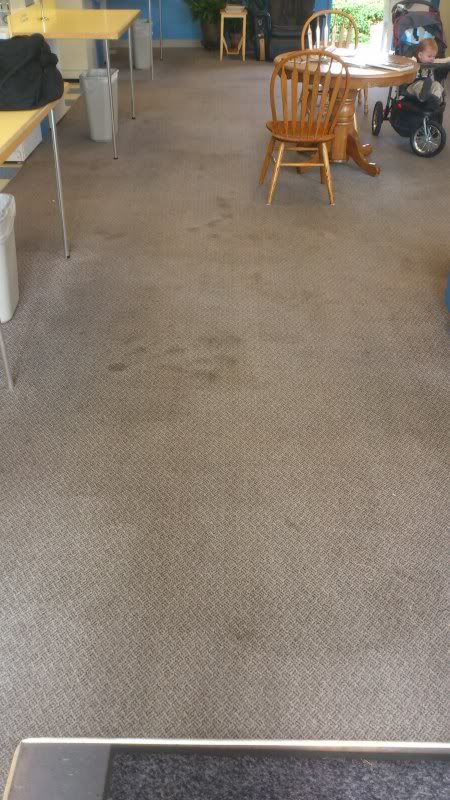

Asked to quote cleaning this carpet, olefin berber in a laundromat, lots of spilled soap
cleaned recently by a local budget cleaner, not really up to date on methods or chemistry
Gets lots of wick-back, the soap doesn't get rinsed out well enough to prevent reoccurring spots.
I was thinking to prespray with a defoamer then rinse
Possibly even to Cimex it after it dries.

Yes. Encap it is the only way to go on that one. You could quote .40 - steam with no guarantees, or .50 - encap with guarantee. Even if you cleaned encapped twice, you would still be ahead of the game. 8)
I would padcap that before/instead of the mex.

Use Chemeister's RinseMaster.
As a prespray and rinse
It was formulated for jobs just like this

Ron I do a few day care centers, they mop the carpet with soapy water.
The only thing that works for this is to run downey in your rinse tank. 3gpm about a quart to 5 gallons.....

I second the rinsemaster.
When I run into the occasional soapy spot I sprinkle powdered Defoamer right on the spot but on a scale that large I would go with Rinsemaster.

i would do strait hot steam(220 F minimum) water(a lot of water) with rx-20..if stains not come off then use carpet spotter. done it b4 ...encap is cheap service for that carpet IMO

i'm with ron, downy will knock it right down . i would spray it with vacaway after and give it a scrub, can't hurt.

call tom at Modernistic and get some powdered DEFOAMER,i used it on a custys 1 gallon woolite spill on her tan carpet and 3 yrs later no re occuring soap spot

After a good flushing with acid rinse I'd encap it to aid inbinding the residual surfactant and to prevent wicking which the old surfacant is sure to enable. O2 rinse and Snake Oil are probably going to be the heroes of the day... And you can post-vac to satisfy your OCD...

that was the plan, thats what I was recommending
They don't want to spend the money.
I probably wouldn't prevac since I know what the result would be. IF I was first in there, yeah, prevacuuming would have helped a lot, but since some really budget cleaners have been in there that do half of what Bob or I would do, they've literally mucked it up.
Steam clean and encap chaser would have been a good solution.
