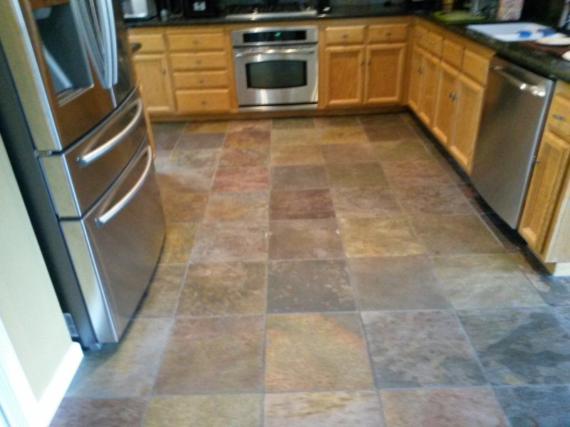

Cleaned and color enhanced some slate Friday and today with Miracle's Color Enhancer for the 1st time, I was in a hurry on this one and I got good results with this stuff, it was easy to apply but had a horrible smell. My favorite was odorless STT CE but I ran out, plus it's thick and has to be applied by hand, what do you guys use to color enhance?

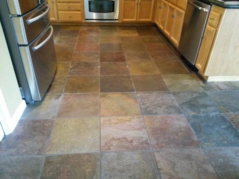

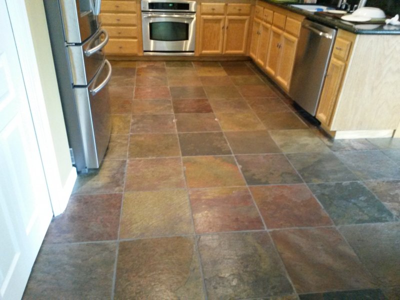

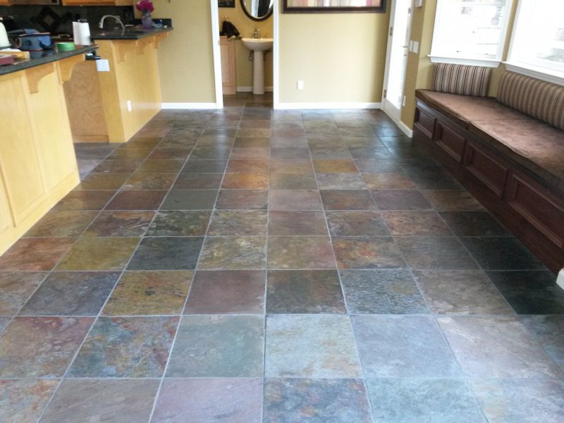

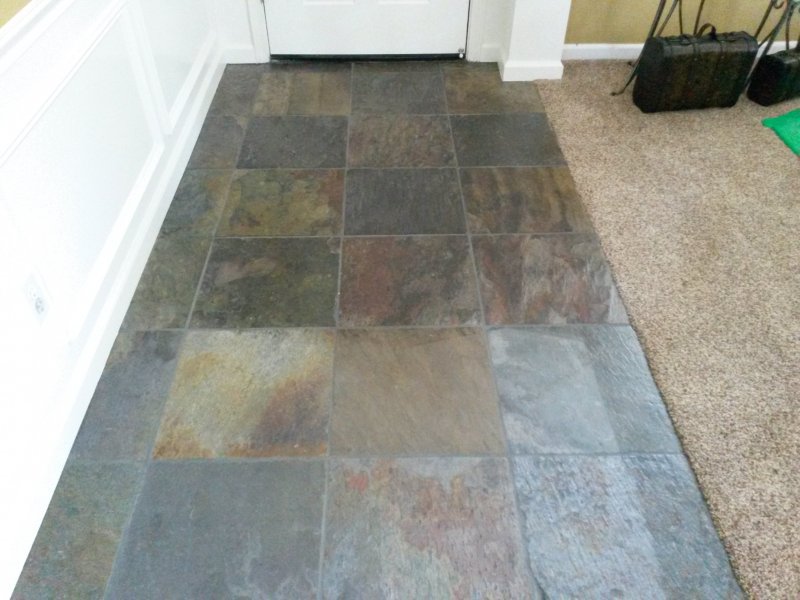

Here's a few more of pics...the pics aren't good because I used my camera phone. I hope it lasts long Mike, I didn't promise them anything as far as how long that sealer will hold up, I let it dry out for 2.5 days after cleaning so the solvent based sealer would bond properly
