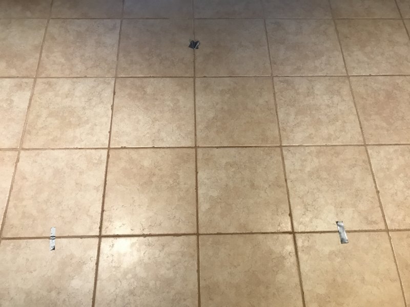

Does anyone do this anymore? I have a customer that has some real blotchy tile I did two test spots and there was little improvement with Oxyblaster and Viper renew.
Have you tried cleaning it with some floor stripper yet? That might help with the blotchyness.

raw
Here is the tile I'm talking about.. Does this look like color seal?

Lol, pic of the day! So wth is wrong with the tile?
