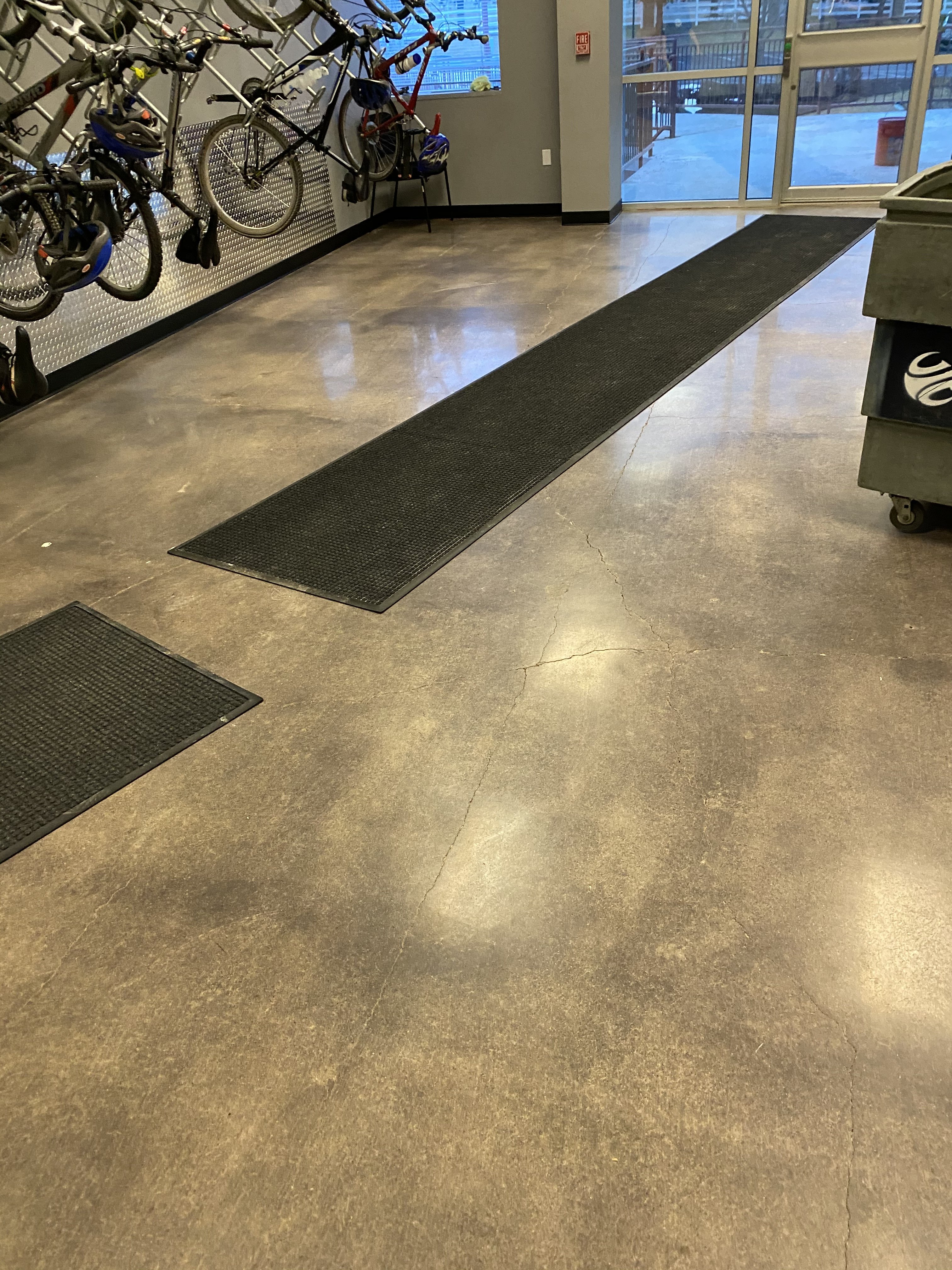

I'd be going to a proper chem pimp
buy a cutback or reboot type detergent (more grunt than an everyday maintainance cleaner)
then topcoat a medium gloss vct finish
buy a cutback or reboot type detergent (more grunt than an everyday maintenance cleaner)
I got a Interlink here what should I look for if I went there to buy?
Like I initially said I not a resurfacing guy so have never looked at those chem much.

I like Pioneer eclipse "reboot" detergent for jobs similar to what you've got, followed by a satin or mid gloss finish
Any of the reputable pro chems will have similar product lines

One more question how many gallons will I need to finish it is about 650 sq ft. The bottles do not say how much it covers.
28,159
1 gallon will be more than enough. I usually just splash it on in an s pattern and mop it around with a flat mop.

Mike, forget name of what we used over on twin peaks. Still have some at shop. We put 2 coats down. And want to say 30-45 minute, so similar.
Down side of VCT wax may be being a bike shop those tire make scuff and mark it up...
Looked at pic, it is hard to tell, You need to profile it. Looks like it has texture= micro lay
