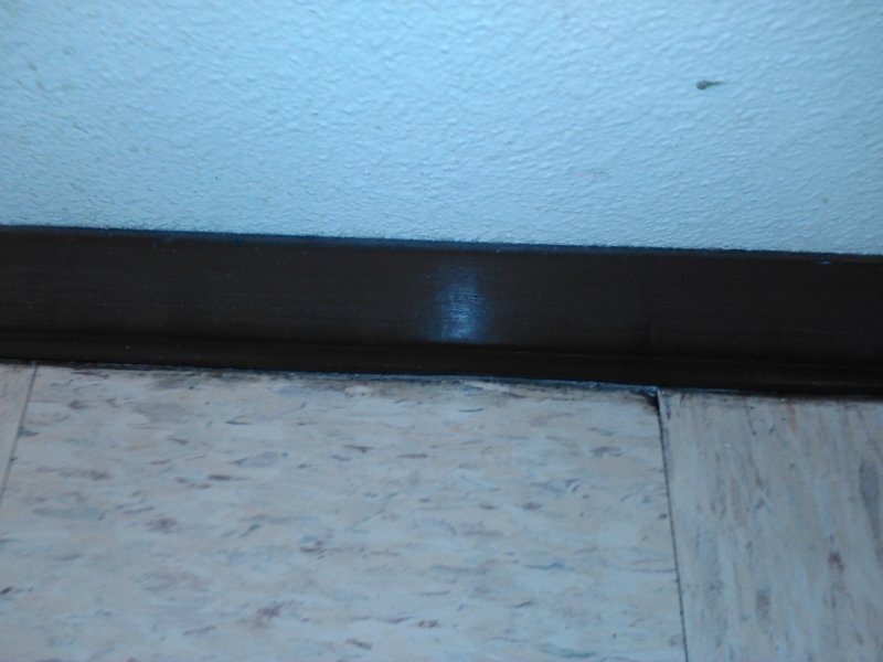

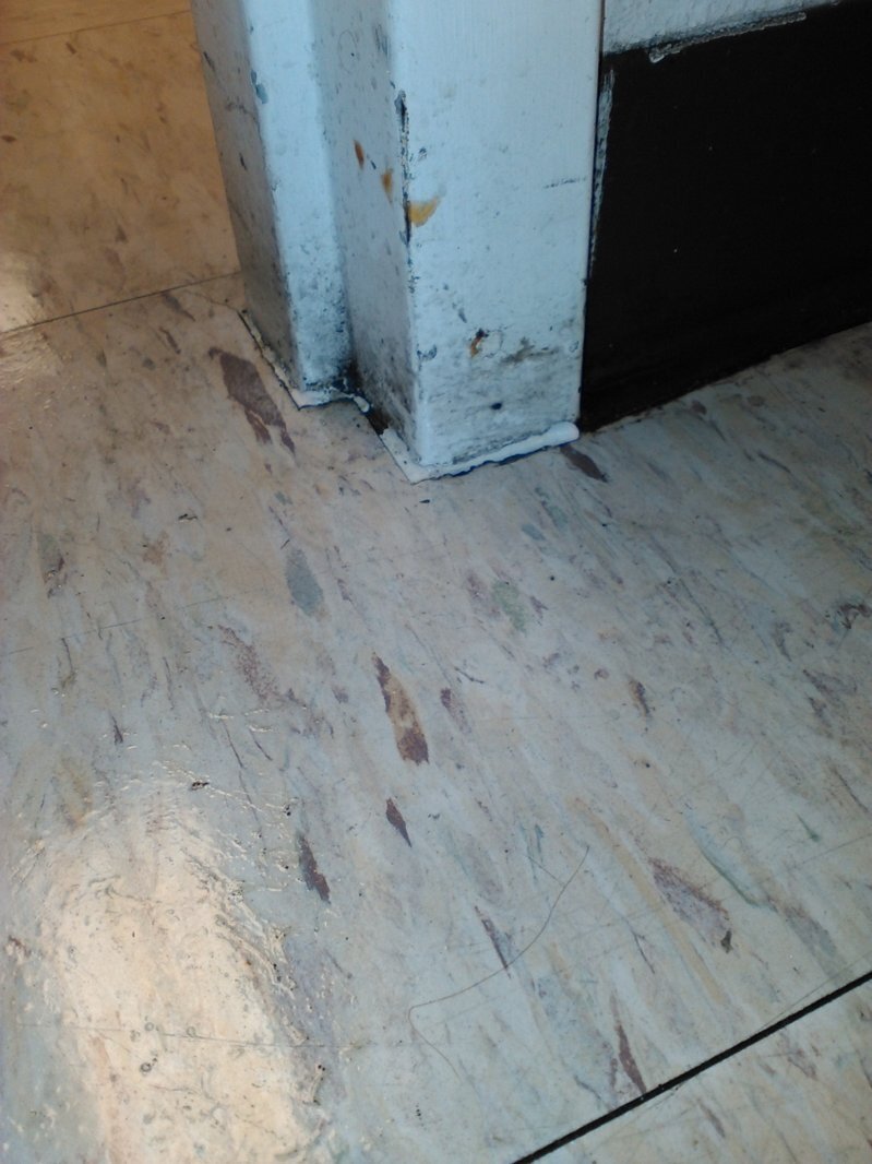

What color is the vct? Off white with some specs of Brown. I ask because I want to know if it is colored(anything but white) if the area of the floor turned white or not. In other words did anything happen chemically and or to try and identify what is on the floor. The floor stripper worked well on the floor, it was the baseboards and corners we had difficulty with. I used the aerosol and when that didn't work I applied the stripper from the jug to the areas and that didn't even do the trick. Apparently they used the same product because we stripped/waxed the floors in the other building this weekend and it was just as bad and primarily around the baseboards and corners.

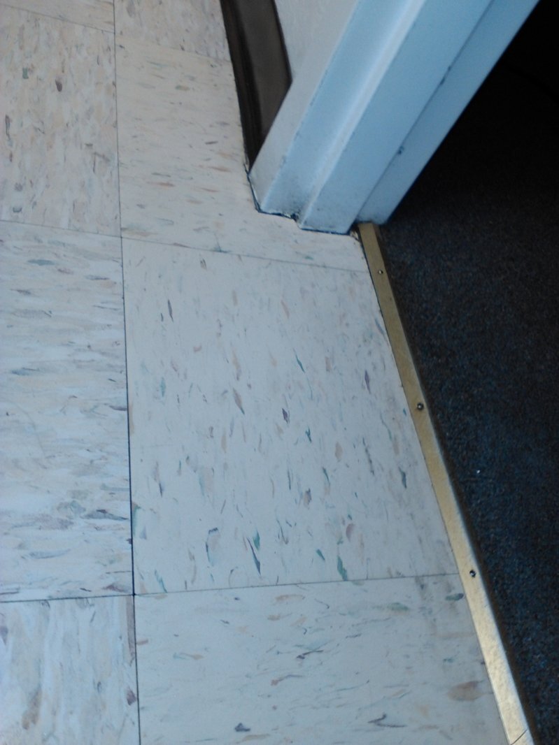

That is bad and will need to be stripped multiple times to correct many years of subpar workmanship and or lack of maintanence.
All that trash and hair in the wax is very unprofessional.
