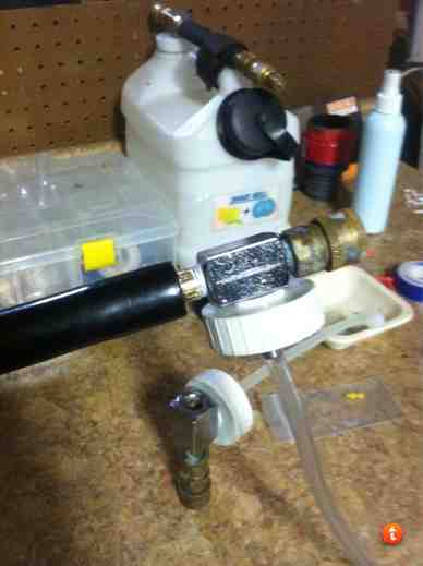

put a video up showing the setup and watching it back fill.....
Its snowing. When the porty gets here thurs it will be easier to work on, so I will try then. Worked on them a little last night but it was way too late to fire up the Genie so...

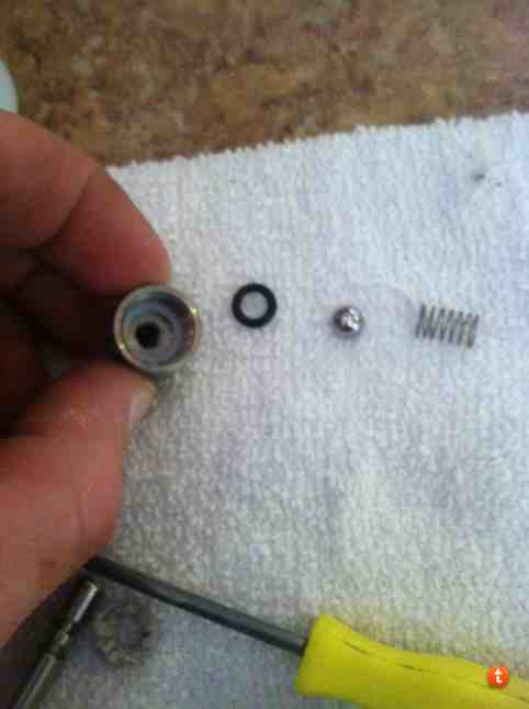

Remove the handle!
Inside the block, in front of the water nozzle is a thick gray plastic looking washer as shown on the white towel.
Also stretched the spring out under the ball. Replace the Ball O ring aswell.
All user repairable with a few cheap parts.
