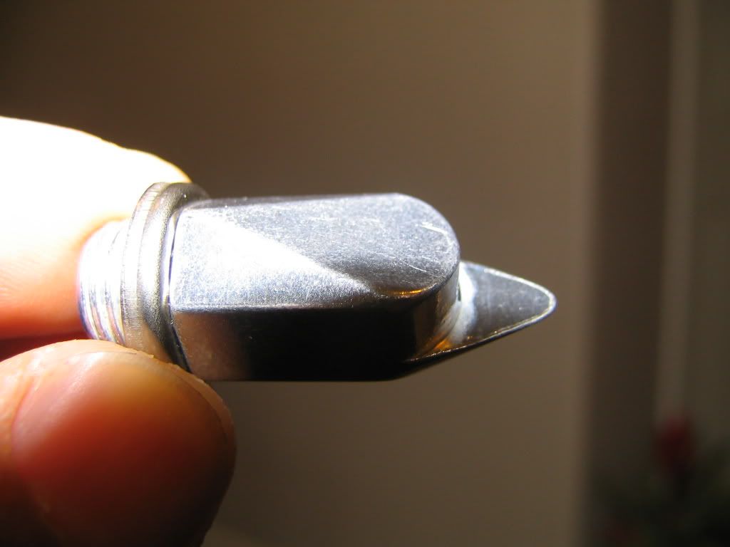

Yeah we have never had a problem manipulating the seam after activation. But it sounds like rather than buttering the edge, you are trying to run a bead right next to the piece of carpet. Have you tried using a seam sealing tip on the guns? If you use this type of tip, you seal the edges like you would with latex on both side of the piece then when you have them right next to eachother under the tape, they reactivate and weld to eachother. We do this with both hotmelt and Kool glide seams or the few that we have tried and on action back and lower cutpile wool, it welds the edges very well.

Sure, it is a great tip and does the job well. Just sharing another way of doing it for other circumstance but it also works well in general. As you say, the tip will work well also.
For some that may not know what David is referring to, here is a shot of the tip used for sealing with hotmelt
Many times, especially on repairs, the method we were talking about works where more conventional sealing does not work or work as well, IMO.
