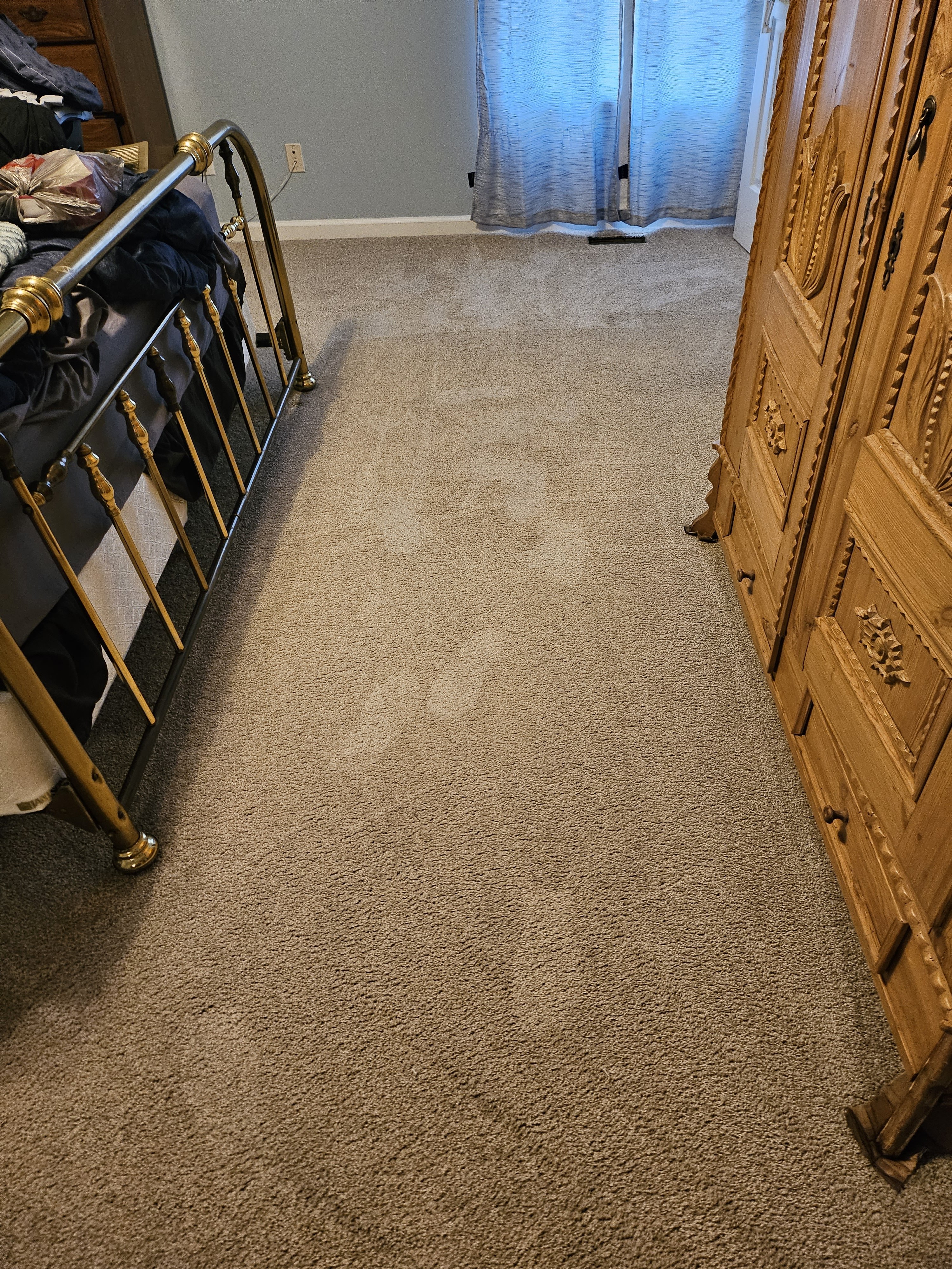

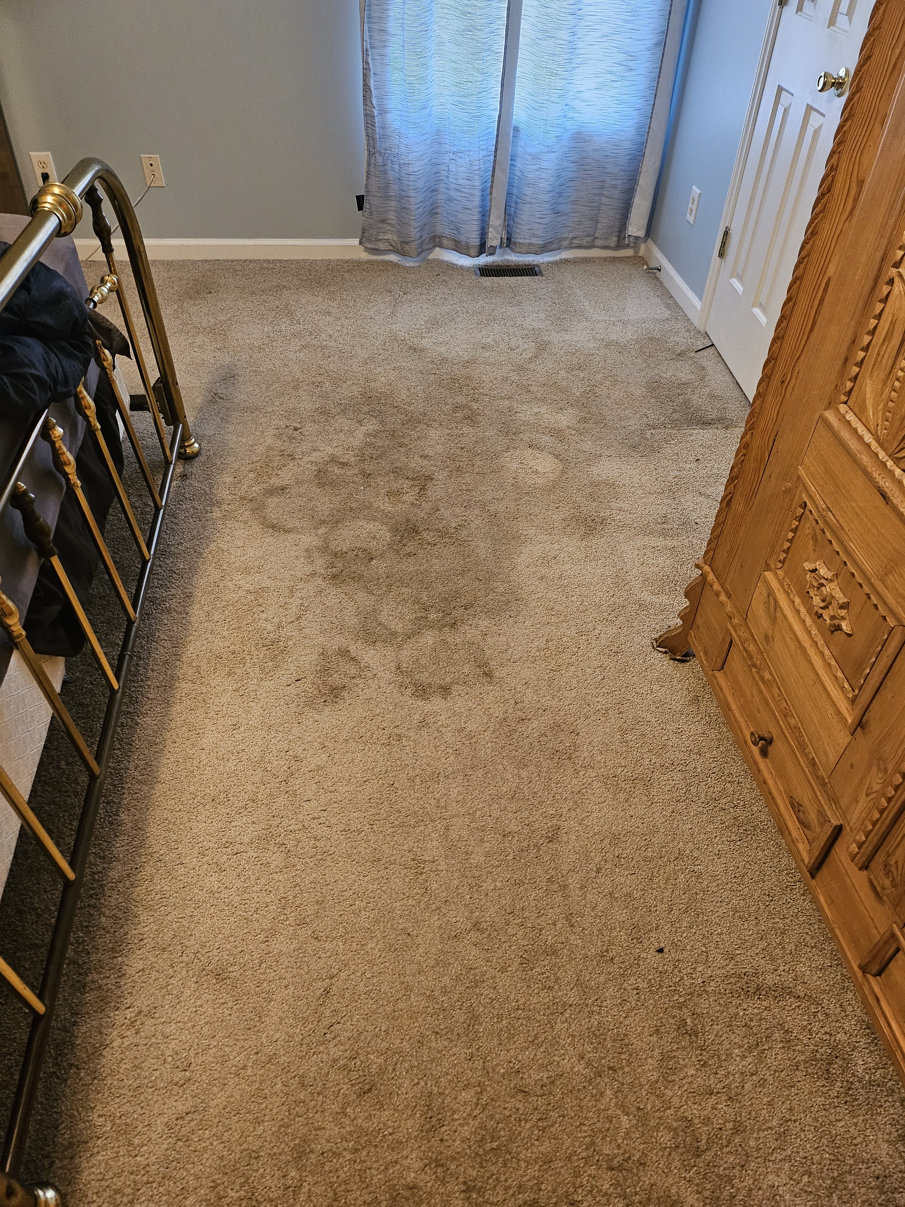

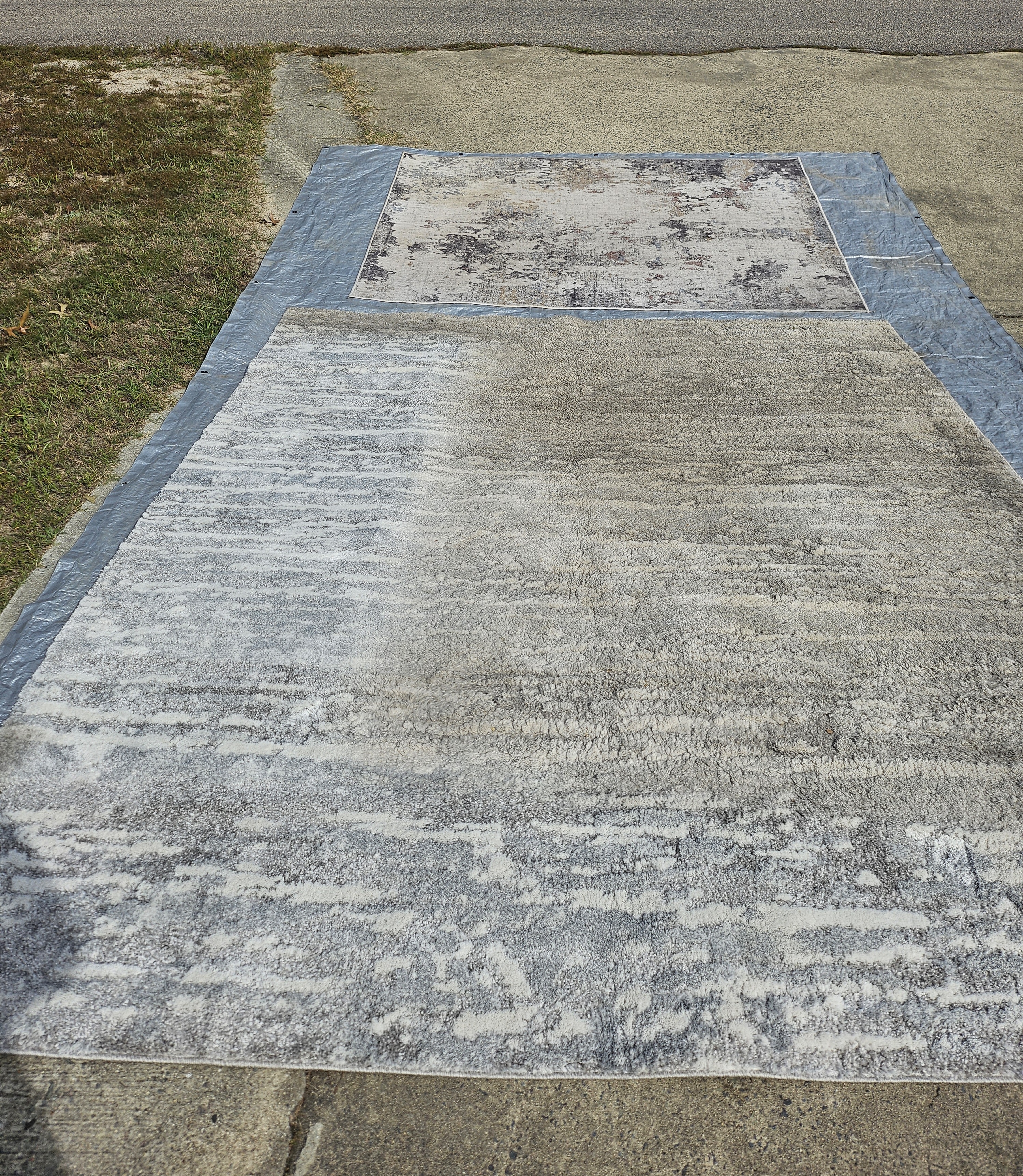

How are guys handling years of dog hair on rugs and carpets? I recently cleaned some neglected carpet and rugs and I let them know it will need a follow up cleaning to really get it 90 percent or better clean. Also they would need to vaccum a few more times over the next few days to get the majority of the dog hair out. Now to be transparent my rates are pretty basic and I'm only running part time so I'm not offering full blow life changing cleaning at the moment but plan to in the future.

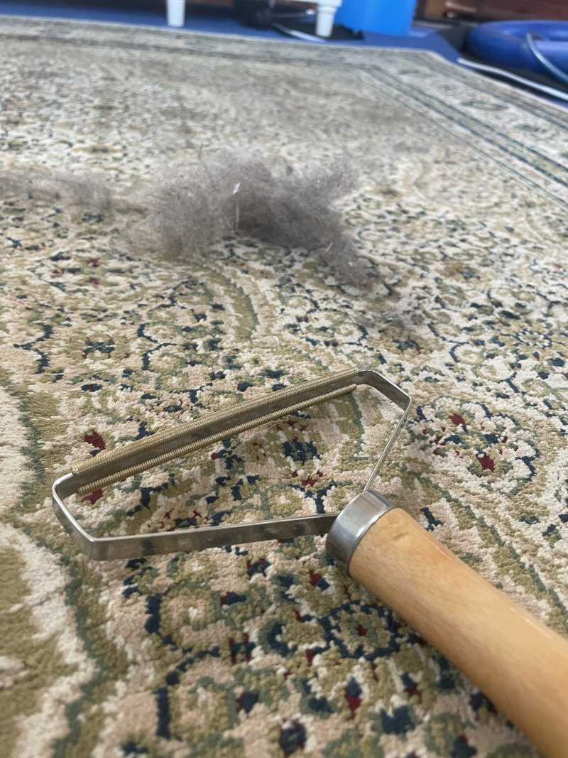

I see some guys using hair removal grooming tools. Any input on that?

It seems what you did with the rug was average, to good. Nothing for the customer to brag to her friends. If that bedroom didnt wick back at all that looked pretty decent. This would have really helped you with the rug. It will get em all.
I tried attacthing to a rake stick, it was a Pia, didnt work good, hard to store. As is works the best for me.

Hsaiiae 60" Adjustable Long Handle Metal Pet Hair Remover, Pet Hair Rake, Rug Rake, Durable Carpet Rake for Pet Hair Removal, Lint Remover Scraper for Rugs, Mats, Couch, Stairs, Black https://a.co/d/gdsL1jt
I've seen these numerous times but wondered if they worked. That's why I asked on here to see what guys are using that have been put through the test. Have you used this one?

Ok the dog is dead that's a start. LOTS of VACUMING the I use Carpet designs a no soap item the owner has used bottles of resolve in the carpets. You might have to use a 175 roto to get a good clean then slowly extract with very hot water or your choise of a rinse .You have to try different things on each job until you find the products that work best for you and the equipment you use things will get better with time. Just rembember nothing works all the time on some jobs. jz

Gotta love the I cleaned it with some products from the store and got most the stain out... like alright thanks for making my job harder lol. So really just vacuuming the hell out of it is the best way. Those hair removal tools worth it or not really?
