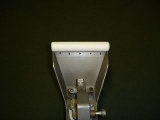

I have one , it can be hard to use in some places, the hide a hose style doesn't bend good, i wish it had a wider head. The small diam hose i think creates to much vac on my blower. I put some screws into three of the vent holes to keep the hose from covering them up and drilled some more <a><img></a>

pic would be nice. Thanks

Don't forget to drill some holes in the back of the tool.
THIS was my first one, I would drill the FURTHER from the glide if I did it again.
