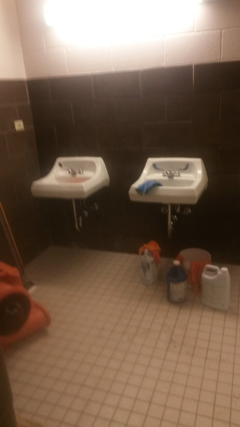

Larry has had zero luck in moving the white off this tile. It's under a sink in this commercial setting. Under the urinals and in the showers look the same.
The tile is absorbent so the white disappears when wet. Acids have no effect. Cant scrap it off either.
My guess is there is or was an internal wall leak causing efflorescence. Seeing how it's 40 years old, the drips lines are from the 30 attempts from other Larrys in the past.

that almost looks like quarry tile. Might be damage on the surface. Coincidentally I just found some polish for porcelain and quarry tile yesterday. I already emailed the company asking about their products.

i agree , looks like quarry tile.
quarry has a texture, so it is bellow your razor attempts
i would try a mechanical, abrasive compound cleaner with a hand machine and hair pad

Try a heavy alcaline like firestorm or shorebest, but test first.
Almost looks like grout haze ???
I found a heavy alcaline gets rid of most of my grout haze.

Anyway. .it's a National Guard armory
Bathroom andshower room
I'd guess the building was built in the late 60s/early 70s
Tried strong alkaline cleaner first.
Pressure wash
Then stripper then acid
Even tried CLR
nothing is touching it
Tried scraping
Tried abrasive scrung pads. .
When wet it's not so noticeable.
Throw the airmover on it and the white starts to show in short order
Tried a floor finish like sealer for stone. .made the not bad areas look nice but didn't do much for the white crap
No clue what to do
There's another bathroom we have to do this week. ..it's not near as bad
But would like to improve the other area any way we can
I'll try Mikes suggestions with the enhancer when we're back the there this week

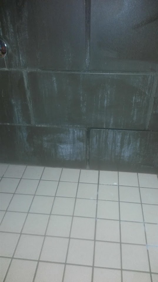

it's looks like some kind of block , Cameron ..if that helps
here's another pic
the block above is standard construction cinder block that's been painted .
BTW, the block on top is flush with the brown stuff
like any solid block wall .
It's not something that was set on/mastic'd too the cinder block
