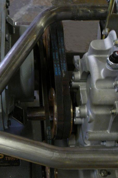

I recently swapped out my old tired Onan 24hp for a shiny new Kohler 28hp water cooled. The switching of things went smooth, but I gots me a problem of biblical proportions.
When I ran it the other day, after about 1/2 an hour I went out and checked things over, and noticed my exhaust was glowing bright red.
I changed a few things today, to try and give it better flow through the pipe.
Does anyone have any thoughts of why this would be happening?

-It's 1" pipe all the way from the engine to the HX.
-The Onan has a higher displacement than the Kohler but never had this problem.
-The Kohler runs at a higher RPM... more output?
-I have welded the exhaust a lot, so that might my issue, with internal restrictions and what-not.
I am to the point of scrapping the whole exhaust and making something new with smoother bends.

We use a lot of Kohler engines on our TMs and the red glow is common on brand new exhaust pipes.
After a few hundred hours or so, the carbon build-up will slightly insulate the pipe. The operating temp will go down some.
1" pipe is fairly small. We use 1.5" SS tubing for the main tube in our headers:
Do you have any right-angle joints in the header??

These things are glowing like they are fresh from a blast furnace. even during the day it's scary as hell. At night, it's insane.
I got an area with some 90 degree bends on it (near the Y of the pipes). and I know for a fact there's some serious restrictions with the welding I did on it trying to get it to fit.
