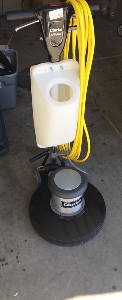

Finally got one of these..

Anyone do much hardwood floor cleaning or laminate what type of pads for that?
Reactions: Tedburton
116,031
You'll want an assortment around
White, Hogshair, Red, Brown and black 3M fiber pads
Cotton OP terry cloth "pads"
Stripped Tuway bonnets
Micro Fiber Bonnets
and the Clean Freak shampoo brush
as well as the Jon Don NylaGrit (or Malgrit) brush.
