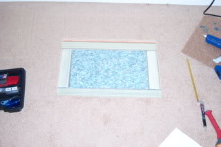

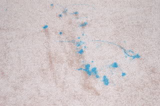

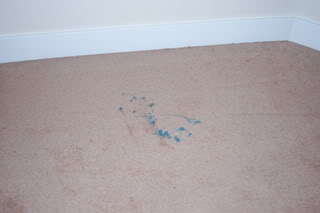

Property manager wanted this gone so the house can go on the market.

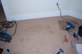

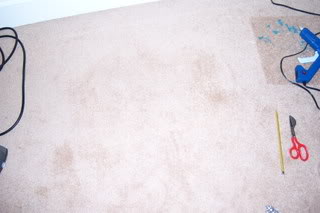

all cleaned up and waiting for the glue gun to get hot.
finished product.
I'll go back tomorrow and clean the carpet.

Why do you use a glue gun to seal the seam? I have seen many installers use latex and it is also what I use.

Both are acceptable but when one used the system Charles was, it all fuses together and makes a very bonded repair, this is not what will happen with latex. Just another way of doing this repair and a matter of preference.

after I sealed the seams with the glue, the donor piece actually sat a little high from the glue. when I used the Kool Glide on it, the donor piece sat down real nice and you could tell that it was in there good. I've only done a few repairs, and I used latex on the first couple. The glue gun is much easier and I was more confident with the quality of the repair.
