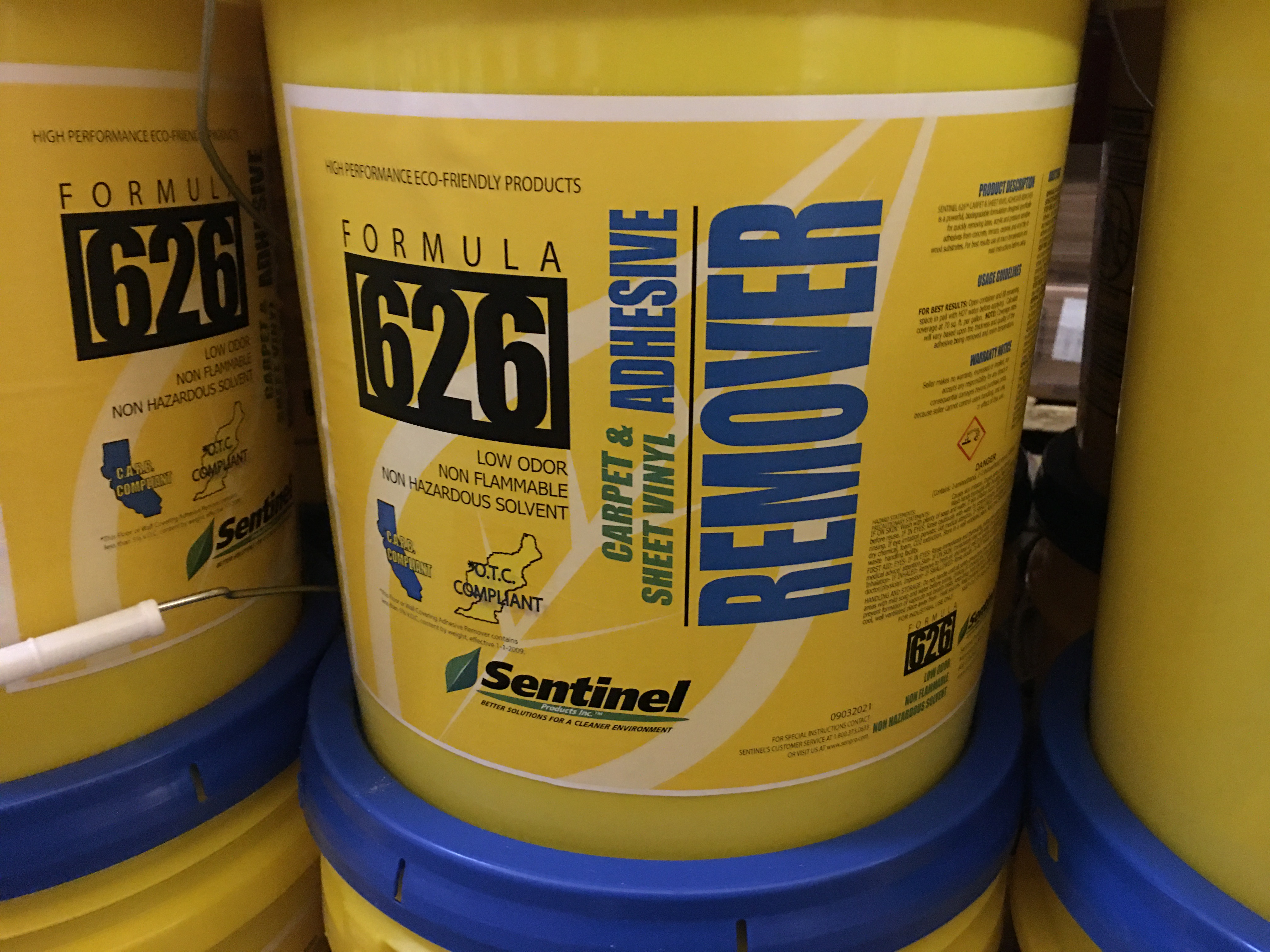

I think lowes sells that adhesive stripper remover, but it’s more of a thick gel liquid that comes in a metal container. You have to apply it, and lay a plastic over it to keep it from drying and preventing anyone from suffocating.
The cost and labor to do that is probably the same as removing the tile snd installing new VCT
I WOULD RUN.
You didn’t get in this business for these kind of headache jobs
14,080
Research this stuff. I don’t know if it’s safe to apply on the floor you’re working on, but it’s a starting point

I think if you’re going to try to preserve the existing floor you’ll have to scrape like mentioned above.
saturating a floor that is also a glue down with adhesive remover is going to result in delamination somewhere
Thanks for the lead. Many reviews say it doesn't work, but some say it's amazing. Formula 747 is more aggressive it seems. But nearly all reviews are for removing adhesive from concrete flooring and I am using it on VCT. I am thinking that it'll work and any that gets in between the tiles will dry and hopefully doesn't become a problem.
Next, I need to remove the ink "3M" labeling that bled into the VCT from the carpet tiles. If it doesn't come out with the stripper then ProChem Ink remover?
