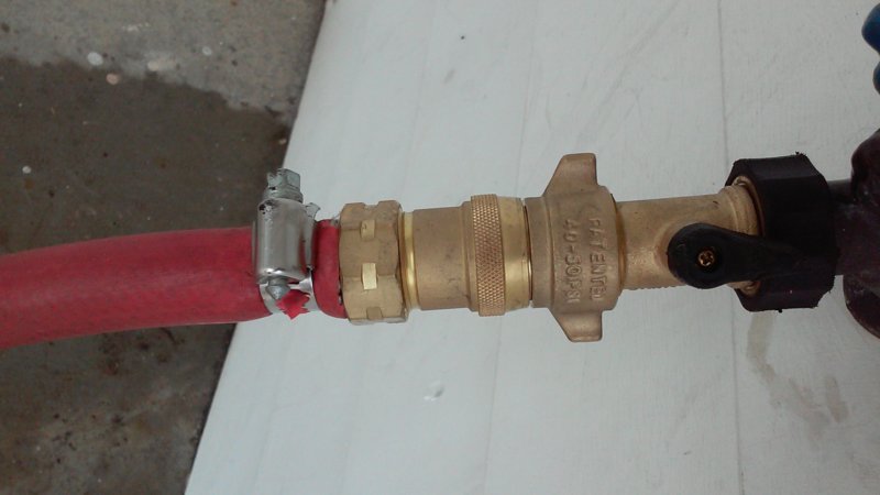

For those that use their customer's water and their water box keeps overflowing...
14,102
After 14years of being in this business, my dumb ass decided it would be smart to call the dealer and see what their mechanic thought would fix that problem. My ignorance is slowly wearing down.
Am I the only ignorant one who just tolerated the stupid squirt of water at the top of the box? Who else hooked up one of these?
27,867
I have a similar one on every truck. And a spare. That makes 2 so far. $5 at Home Depot. The screws fall after a while, take the screw out and put some thread lock on it.
14,102
I was told to look for an RV pressure reducer. My crappy home depot didn't have one, so I had to go to the little hardware store and pay $20 for it
14,102
Does it matter if it's on the hose like you see, or should it be on the inlet on the tm where my hose connects?

I like that the new Sapphire unit have a pressure regulator built into them.
Lucky them...
Be nice if the rest of us could update our machines... Or at least let us know when an update(large or small) comes out.
14,102
Lucky them...
That's why i started this thread. I found a little update for those that have a water box without a pressure reducer on the water inlet side
