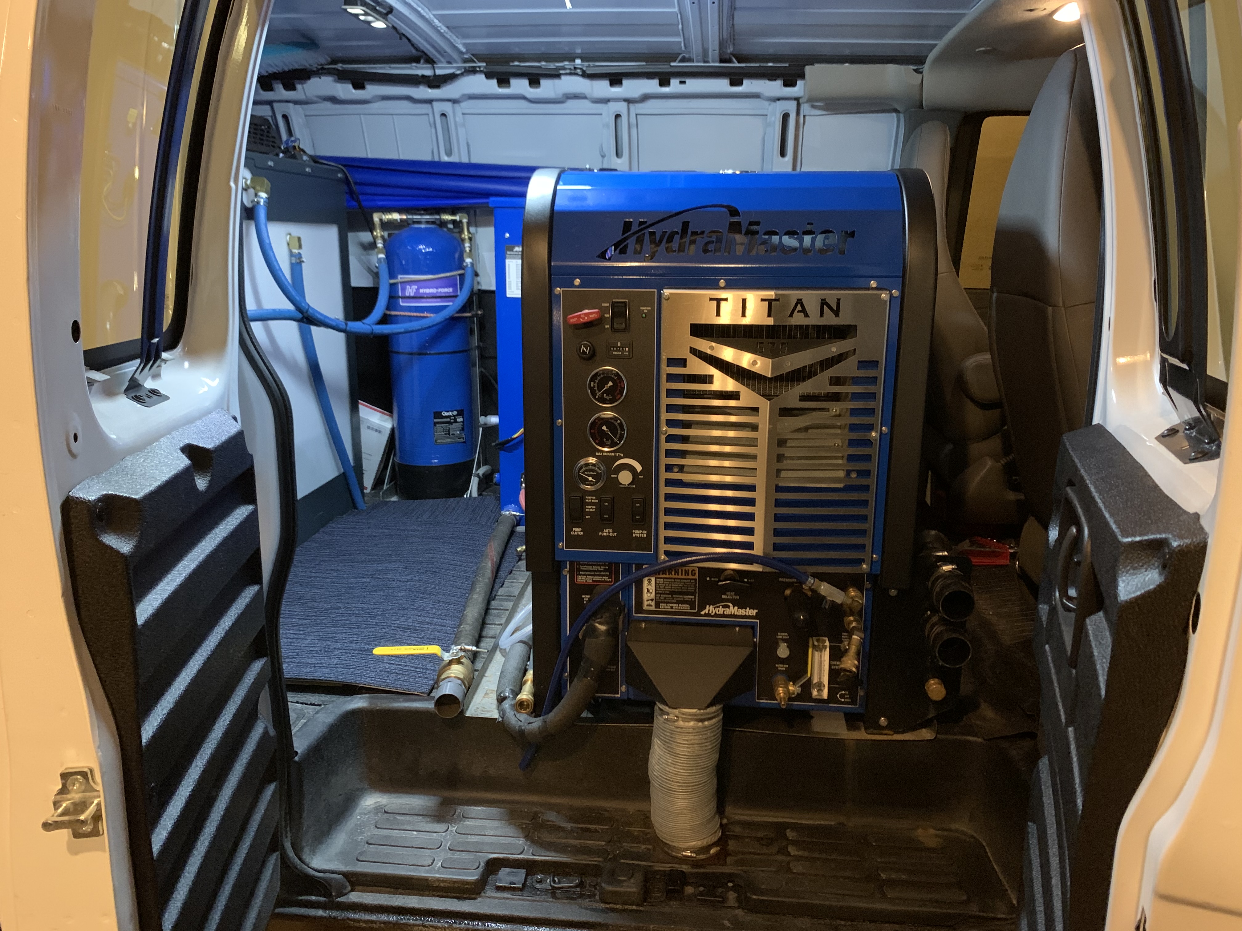

Water Softener: What is it? How does it work? and Why is it important?
soft water cleans better than hard water. same as trying to wash your clothes in hard water. It also keeps the TM lines free of scale buildup. I have a 5 year old TM and you can disconnect any water line and it will look like new. Never descaled a TM in my life.
so cleans better, easier on your machine. no brainer.
So how do you go about getting soft water? Is it a machine? And additive? A filter?
How complicated is it to setup? Are there any drawbacks?
What kind of cost would be associated with it?
this is the one I use. Just mount it in the van near the waste tank. run the water through the softener before it goes to the machine, either from the homeowners water source or an onboard water tank.
I just put in salt every month, but yours will be different depending on how hard your water is and how much water you use.
No drawbacks that I can think of.
Cost is for salt. Cheap
