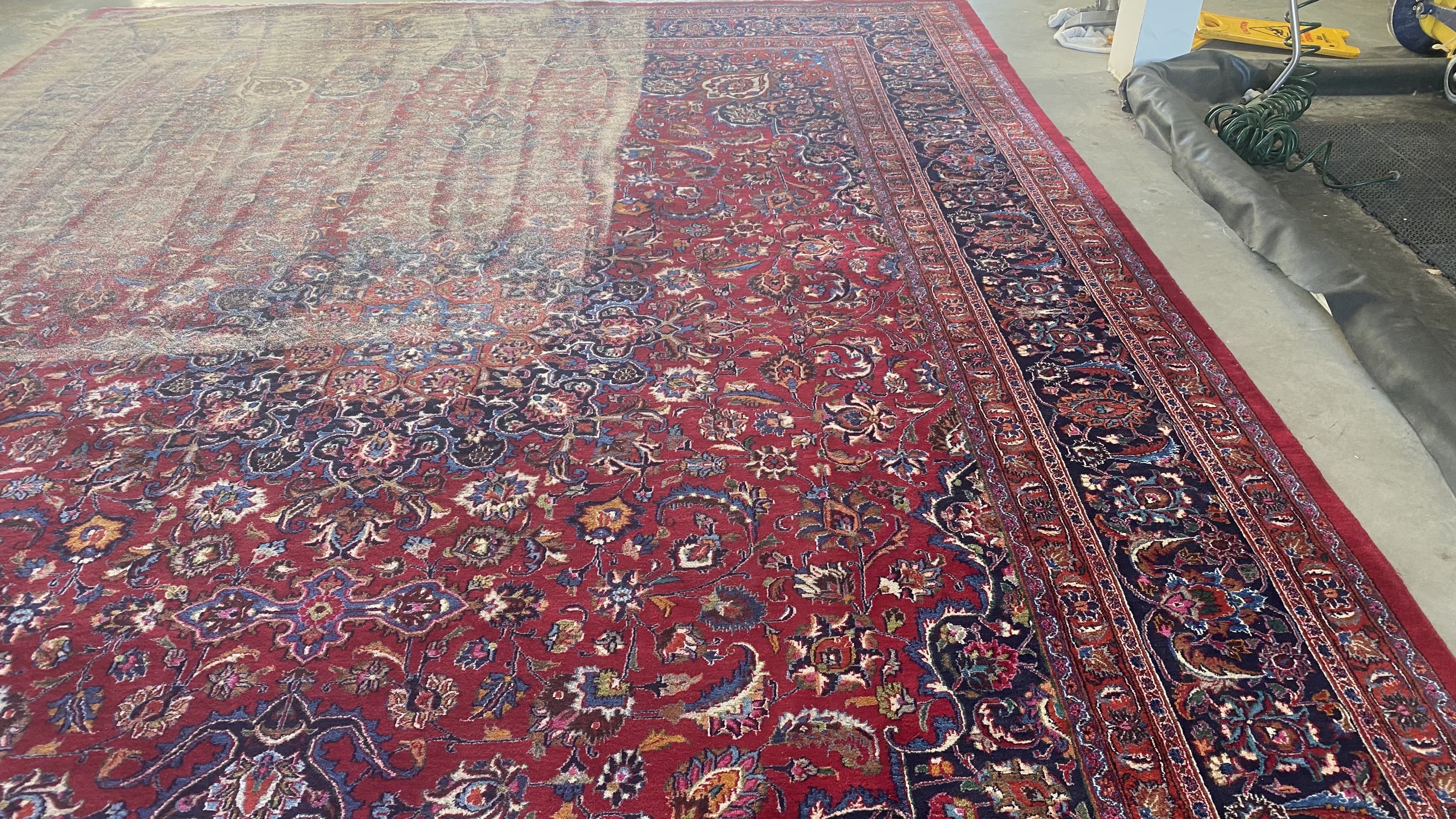

I am going to need to flush one urine soaked corner
that will be a problem, your water is going to create a ring of your sponges. if you knew you were going to have to get some of it wet you should of got it all wet.
24,029
It will be fine. I've been flushing this thing 3 hours. Rapid drying it now.
