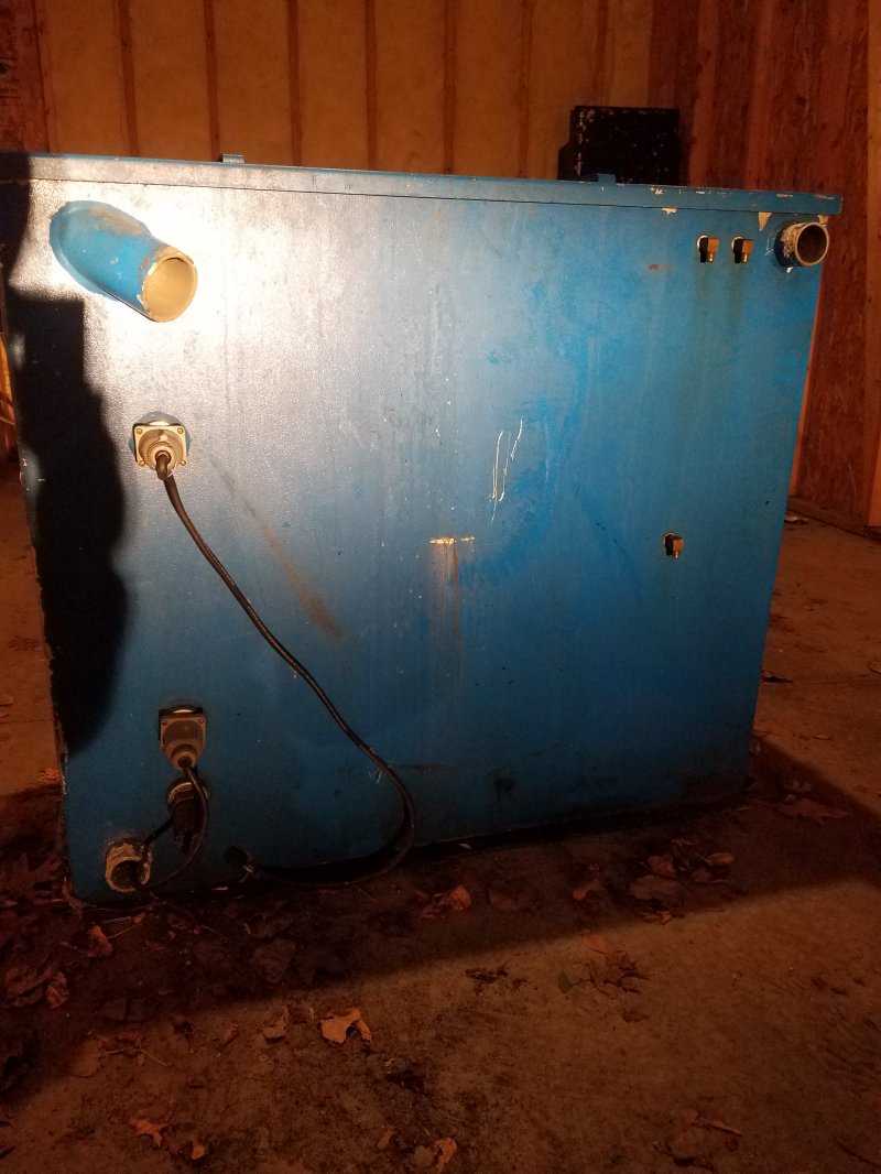

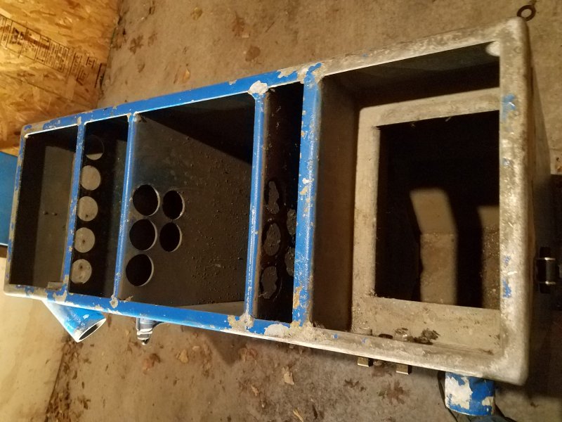

Here is a 60 gallon..
Able 1
Apr 12, 2008
6,469
Wi
Keith
I'll take more pictures if you want tomorrow if you need them.. I took more but they won't load for some reason.
