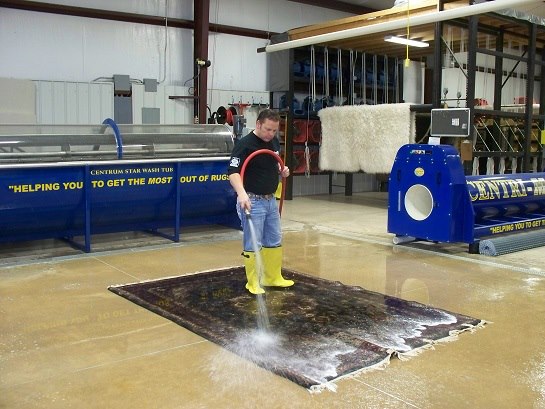

Great Example of Wash Floor with Perimeter Drains - No curbs

Hello Nate, my floor drain are plastic 5'' wide 5" (deep). The drain by the wash tube is 8" wide x8'' (deep) the wash floor is 20' X 25' and is 1" higher in the center which lets the water cascades all four directions. Hope this helps.

The drains themselves don't have to be plastic. You can cut the drain trenches and pour a concrete bottom, then coat with Herculiner if you're concerned about chemical etching. The grid tops should be plastic though (I think reinforced fiberglass) or you'll spend a lot of time fighting corrosion.

Thanks Rodney and Uncle Brian!! My floor has a 1" slope in it, so I don't need to re-pour it... Great idea on making a concrete bottom... This whole time I was trying to look for trenches...

The Flakotti's actually dry fairly quickly after going through the centri maxx (Dry and Fluffy) Thank for asking:)

Hello Ron, We use the wash tub for most of the hand knotted, machine made, and some better quality tufted rugs, inspection is key when using the washtub. The cheaper tufted are rotary scrub (soft brushes) and top down rinsed both side (low moisture).

Ron, I don't own a tumbler as of yet. The drying tower I built about 8 years ago and yes still doing the old pirate ship way of hanging rugs.
