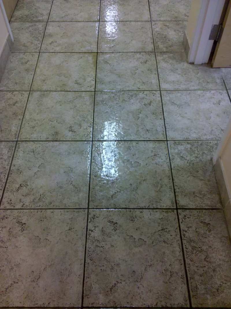

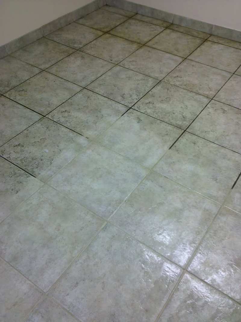

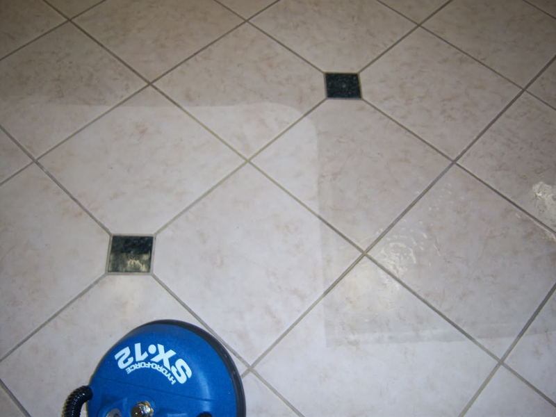

This was a non profit health care clinic that hadn't been cleaned in about 8 years.

Robert I have a Gecko tool I'll use sometimes. With this job since the baseboards were tile I was able to just tilt the tile tool up and clean them easily.

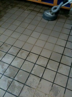

Hell its worth a try, i like this pic because its actually removing floor finish someone had put on.

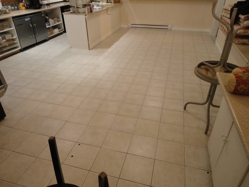

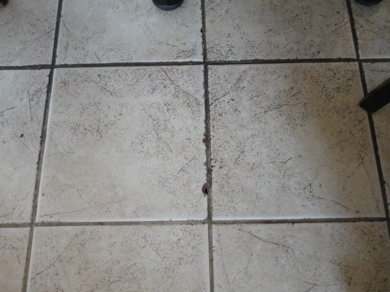

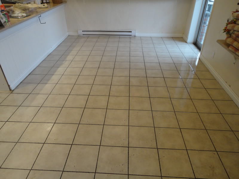

Here's my first T&G job.
A bakery that had only been mop cleaned for 8yrs.
We were thinking of grout sealing as we didn't know how well the grout was going to clean up. Fortunately it cleaned up nicely. Used O2 with Hotsauce and Attack. Scrubbed with a Whittaker and rinsed with Mytee Spinner, 1000psi, 240F
Used a pressure washing gun with an 01jet to clean the edges where needed. The Spinner got right up close to the edges along the walls.

Warren, did you use an edge tool before the Turbo?. which was it?
Albert
Albert I didn't need to I used modified 02 plenty of dwell time and scrubed grout lines.

I use the SX12 and for edging, I use my carpet crevice tool with a teflon boot on the tip. Works great.

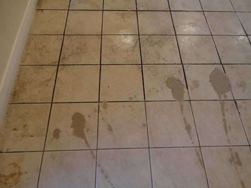

I thought the Floor was going to give me he'll because it had multiple coats of sealer applied To it over ten years but itcleaned up very well.
