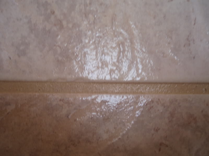

Can you tell this has been color sealed?
Not horrible but urine stained none the less.
B4
After
Apply a very thin line..
Scrub it in with a tooth brush..
And wipe off!
To the left is Color Sealed..
Nasty door jamb area full or Mop staining.
POW!
b4
after
A must have..
safeclean
Apr 9, 2007
159
