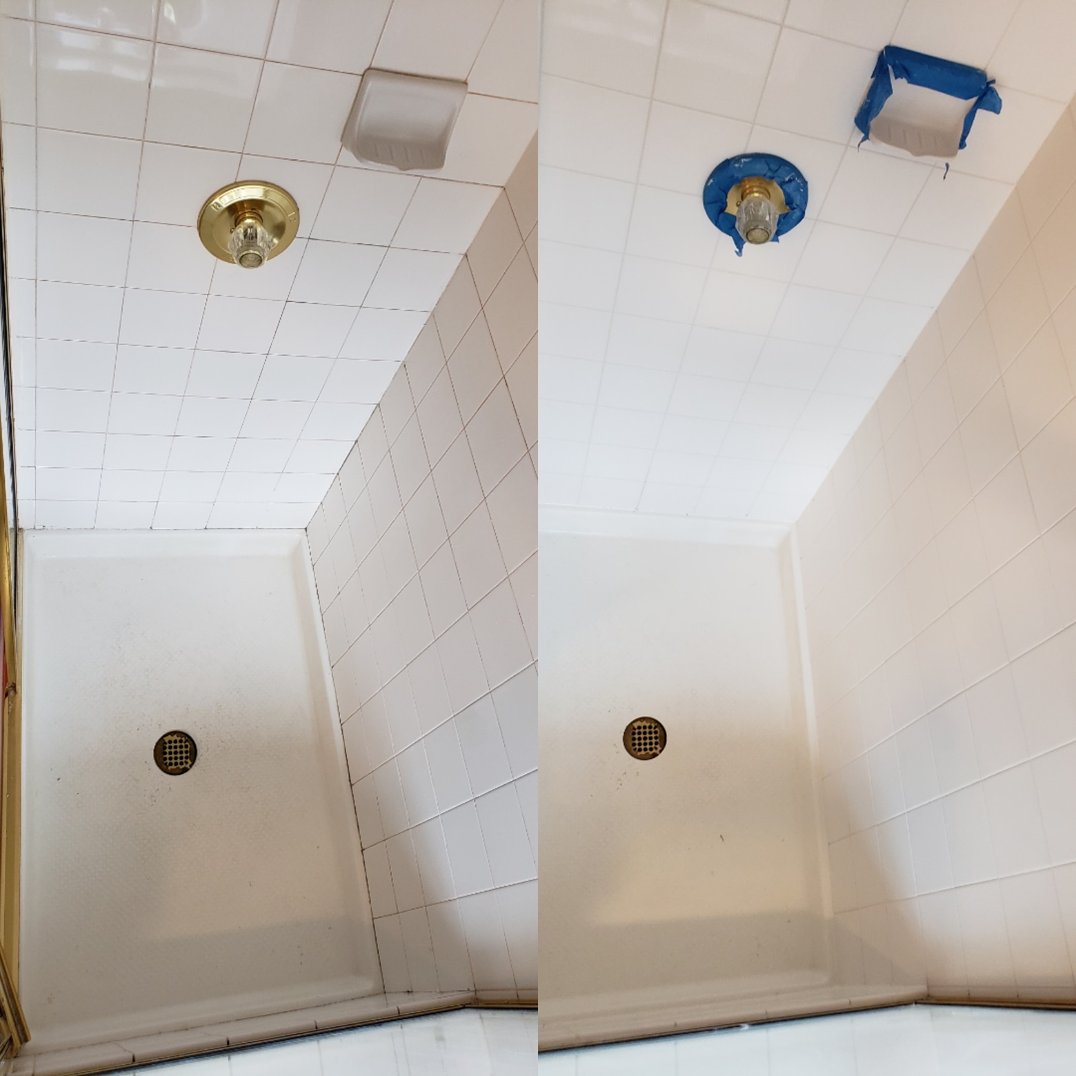

Bjorn Marshall
The bag of grout mix should have the cure time printed on it.
I would wait till it's cured b4 applying sealer
You dont need to wait with Gundlach on fresh grout... but we only use it to seal after cleanings. The grout we install does not need a sealer thats the whole angle we take on our regrouting jobs. We only use Perma pool grout, its 100% waterproof made for underwater in swimming pools. Nothing better out there for showers, this shower will never need sealing again
86719
