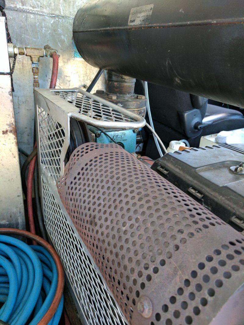

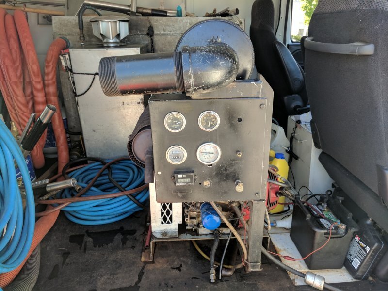

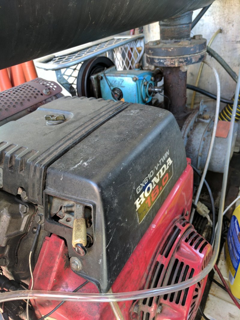

Here's some pics.
Cfm is about 300 at 3200 rpm, I usually run it at 14 inches hg. Heat will fluctuate between 200-230 degrees f depending on the outside temperature. Although I designed it, the main assembly was done by a company specializing in industrial vacuum systems. Cost was about $8000. I probably wouldn't do it again. For just a little more you can buy a nice heat exchange unit that will come with a warranty and dealer service. This machine was designed so all the components are easily replaceable which means I will probably have it for the rest of my life. I would really like to have a heat exchange machine like a Legend or a SS 370 but just can't justify getting rid of this one.
