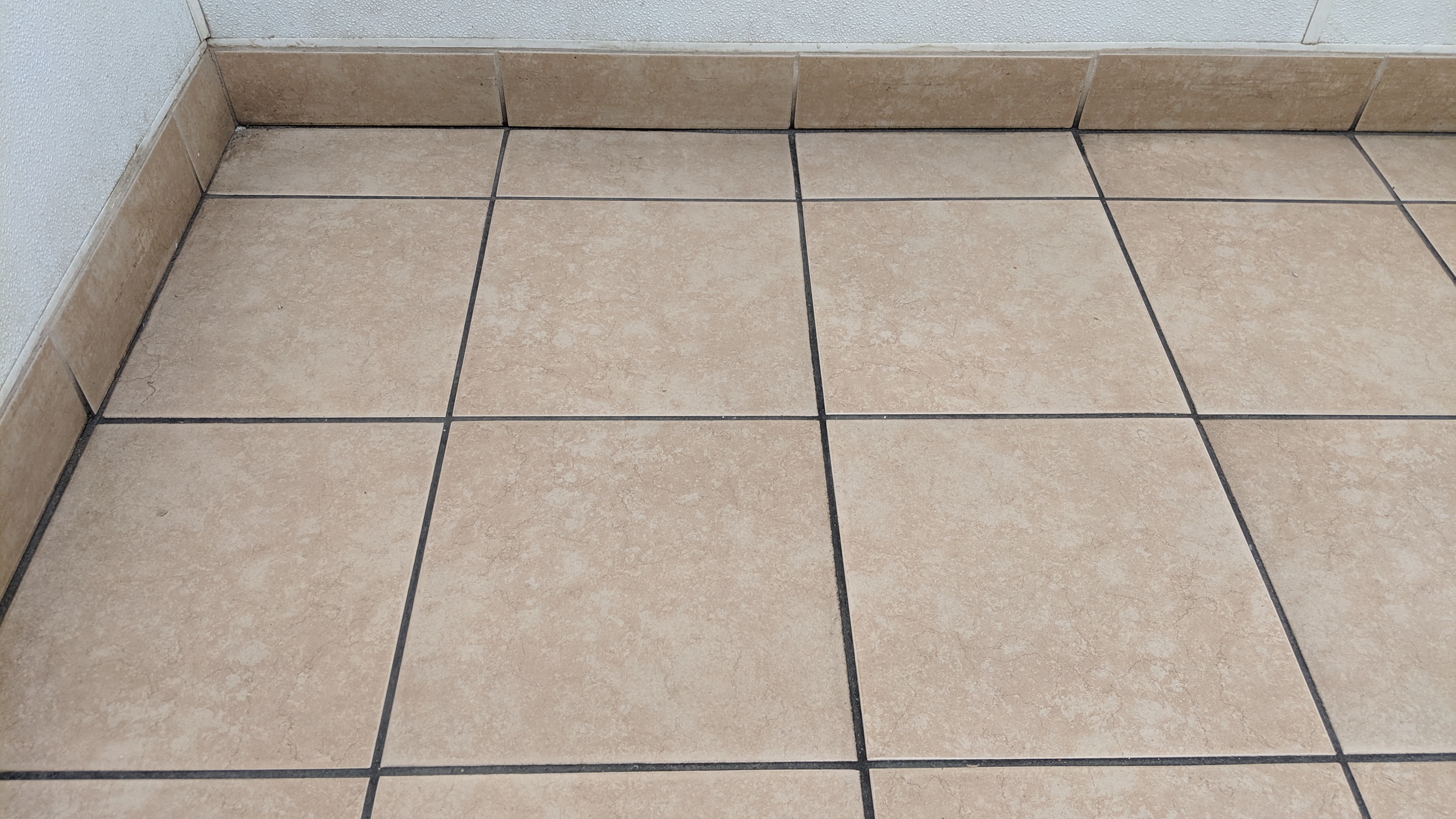

14,080
Dye the rest of that white grout on the top of the trim to black. Then clean the floor with a Neutral cleaner to get the piss off the floor at only 500 psi on your tile wand

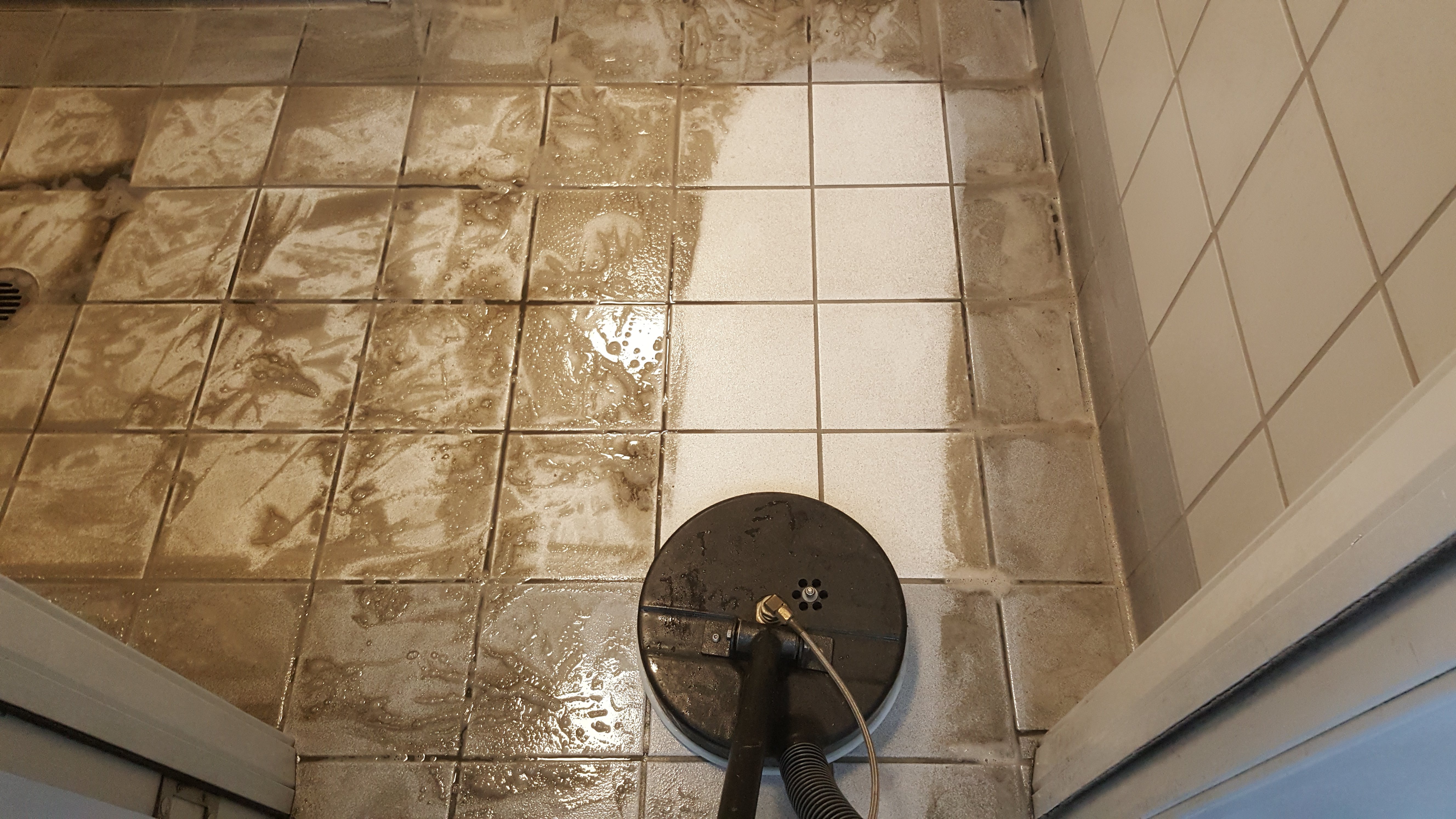

Tsunami, poll brush and 1000 psi rinse
Prochem Professional Acid and rinse
Take it or leave it

Everything we use is dummy downed so nobody can get hurt. Our restrooms are cleaned daily with a Kaivac. That's basically a touchless system where a cleaner disinfectant is spray applied and then 500 psi rinsed, followed by extraction.
