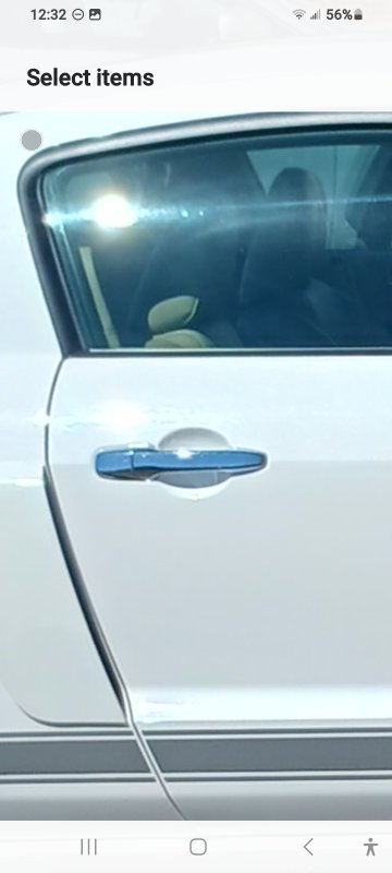

Starters are manufactured to fit a certain solenoid rather than solenoids being designed and manufactured to to fit specific starters if that makes sense. In short if your in good with your local auto parts guy you might be able to go thru a few catalogs and parts on the shelf and find a solenoid that is the same as what you have. It might be to a starter for something totally different but it has the same solenoid. To give you an example of what I mean. I wanted chrome door handles for my 2007 shelby mustang. Ford didnt have um but i foumd the exact same handles that a were on my mustang in chrome on a lexas bought um and were an exact fit. In short as lomg as the starter is good if you're resourceful enough you dhould be able to find an exact fit solenoid.
