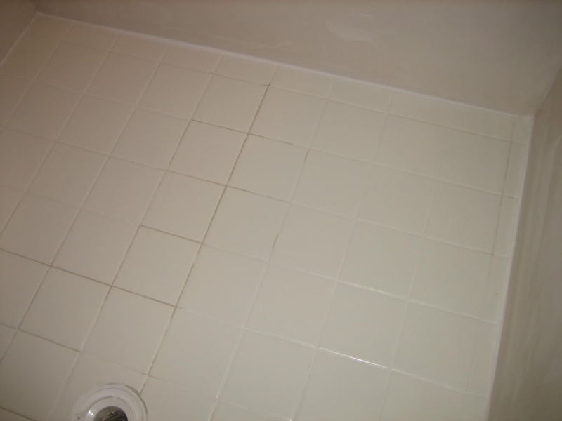

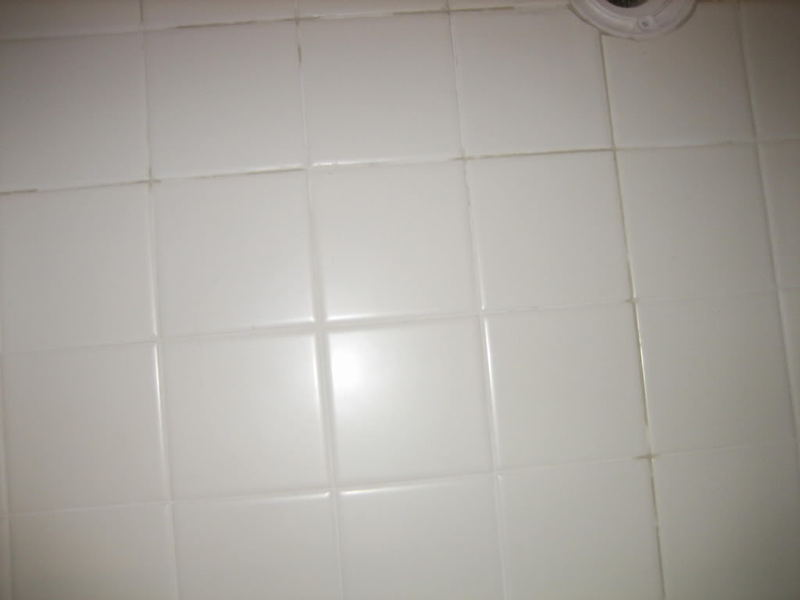

What am I dealing with here?
Customer emailed me some pics of tile that was regrouted two weeks ago and no water has been turned on. She says it is grout bleed back. Can I just apply some color seal over this or does it need something else?
danbrown
Nov 14, 2006
39
Assuming the grout and caulk were in terrible condition when you did the restoration, there is moisture in the pan that is wicking through.
Were I in your shoes I would color seal it and sleep soundly that night. Its funny though, acrylic showers always end up coming back to bite me in the ass in one way or the other, so much so that I am going to start excluding them from any shower advertising we do.
115,940
Unsanded grout :!:
Color seal wont stick and even if it were sanded the last thing you want to do it trap moisture underneath with colorseal.
It'll peel off in less than a year.
Put a air mover in there for a few days to a week to dry it out than put the priciest solvent sealer you can find
Dry Treat preferably.

This is exactly what I was going to say. Un-sanded grout will not hold the color seal. On shower pans with un-sanded grout we re-grout all the pan. Shower pans suck!

I'd rip out the caulking and put a small LGR dehu like the Evolution in there to dry it out, just an air mover may work but baking it out would work a lot faster, and ensure better drying.

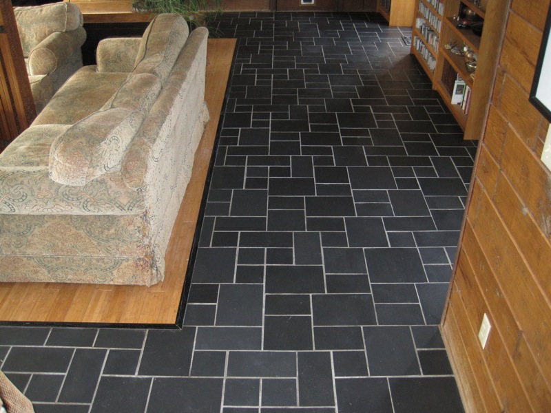

That one was stripped, acid washed, and enhanced. If I recall the slate was pretty smooth and the grout lines were the right depth for CS but she didn't like the combo price so we just went au naturale ;)
I would have colored first. I find the enhancer will tend to eat up light amounts of color seal haze.
Johnny
Oct 22, 2006
2,375
La-Z-Boy
Johnny
You acid washed natural slate?
I did a slate floor in a restaurant that had been mopped with an acid cleaner that caused etching in areas.
danbrown
Nov 14, 2006
39
Test first obviously. I have never encountered an acid sensitive slate in my neck of the woods.
