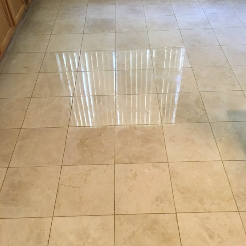

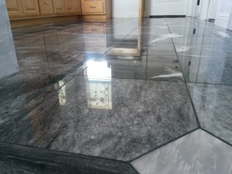

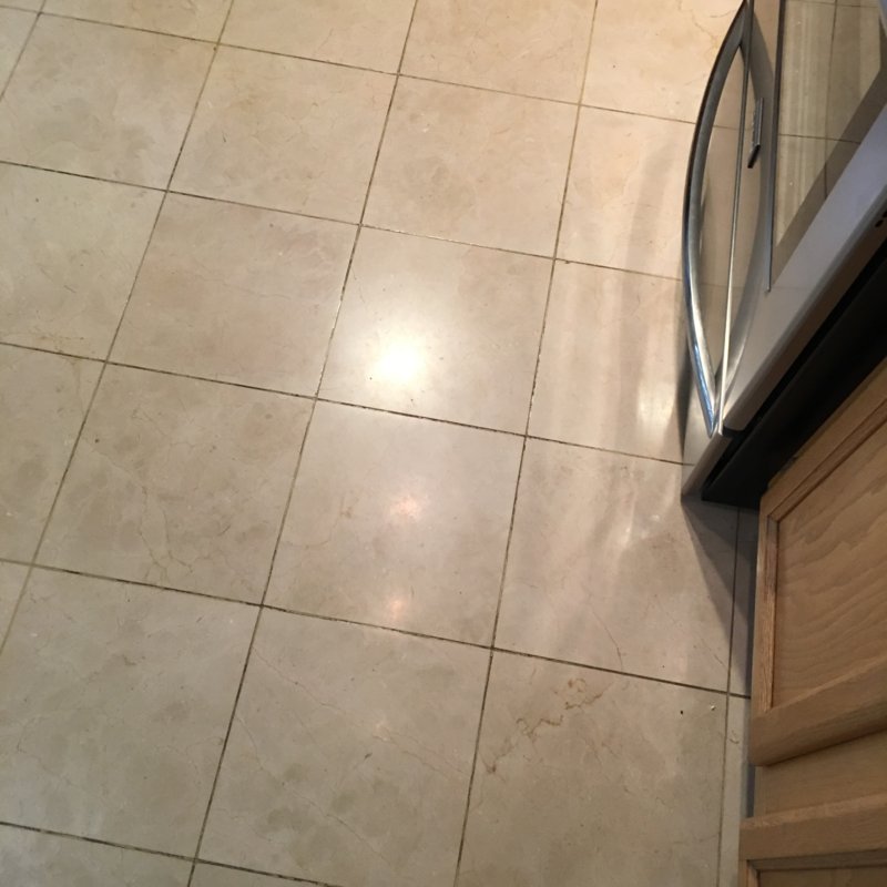

Ok I got my certificate for stone pro boot camp. Spent a boatload of cash on crap and finally did some marble.
220 sq ft $660 5 hours I need to speed up
We used a 400 grit diamond disks on a 40lb driver, switched to a 800 grit then used EMP
Rinsed with stone pro deep clean
Sealed with cobbs ultra seal.
When I gave this bid she needed some grout repair so I referred her to a competitor, he never called her back so I got the job.

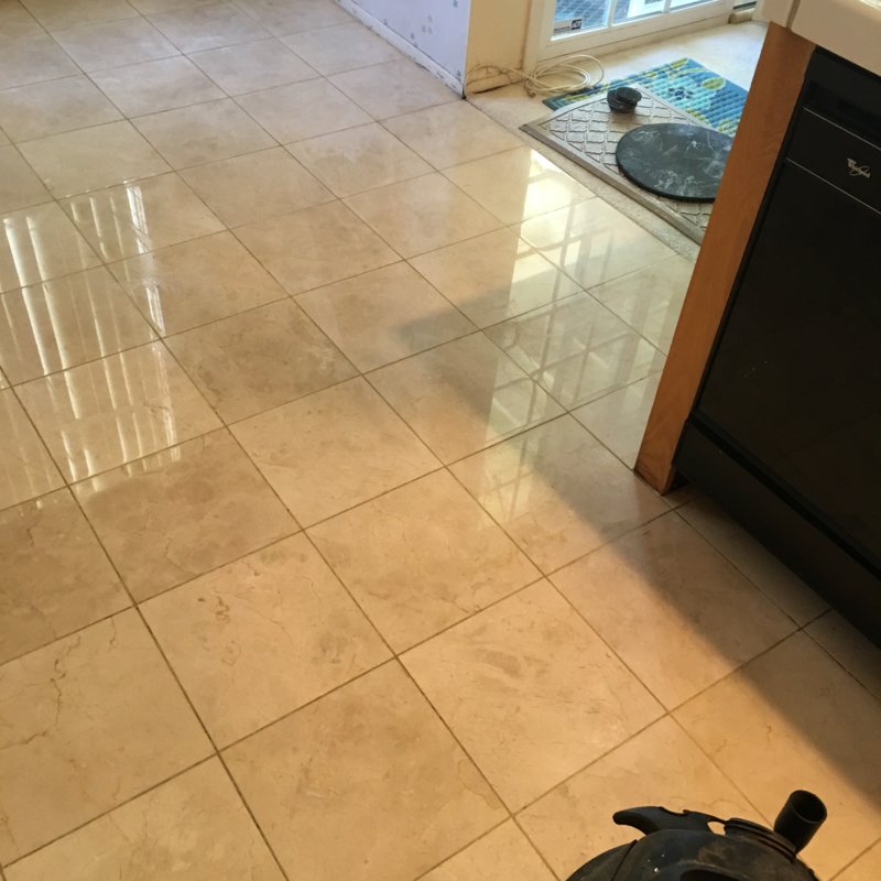

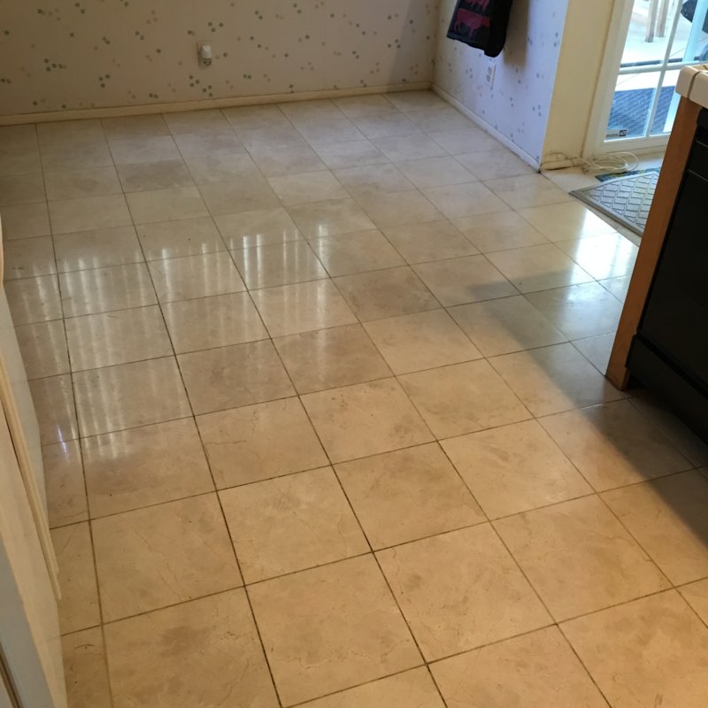

Are there before shots in those?
You could make a nice collage for your site or FB
11,495

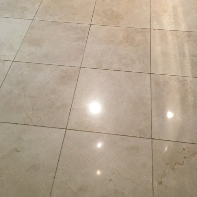

Ya first pic was before so was 3rd. It had some reflectivity but brightened up a lot and had more reflectivity when finished they were happy.

Ya I agree a 220'first would of really got the deeper scratches out. In the class for stone pro they did a floor complete 400 -800- polish.
I went ahead and used the 1800-3500 on the half and it was considerably better with each grit we hit it with.
Right now I have 400-3500 I need to buy 6 of the 220 I have the old 40lb driver plate what a pita.

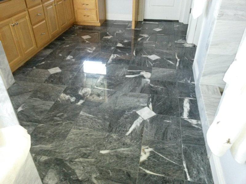

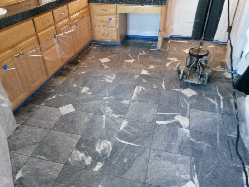

I don't do much marble here, we have lots and lots of travertine in my area. But here are some pics in a large MBR marble that I diamond honed and polished in 4 hours a while back.
220- 6 passes
400-8 passes
800-4 passes
1600-2 passes
3500-1 pass
Polish
