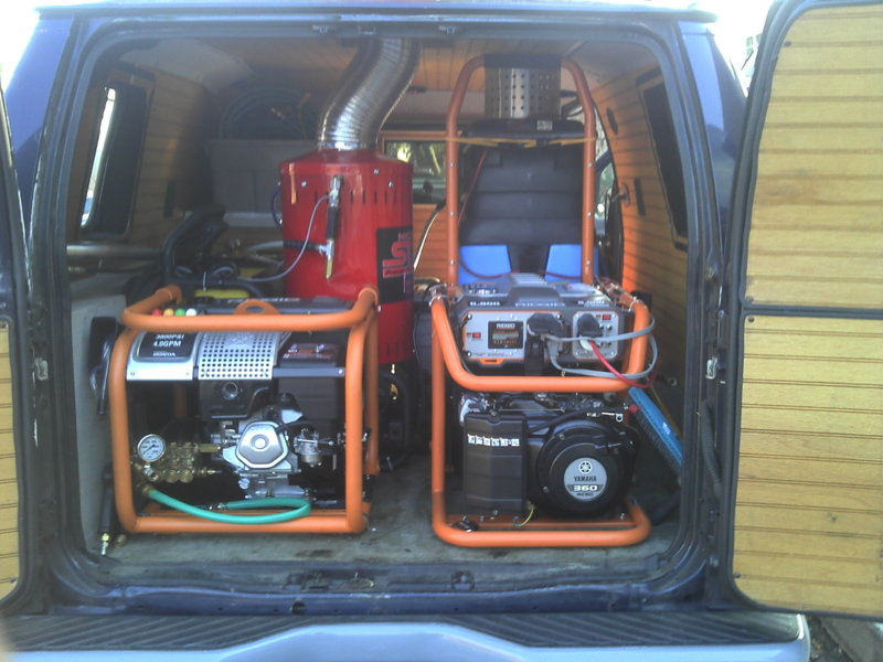

Been there, done that............Thought I was smarter than everyone else being well ahead of ETM curve, when it was mostly just a concept, before everyone else jumped on the ETM bandwagon ................gave up on it a long time ago.
Overcomplicated
Overkill
Overpriced
Set-up and break-down nightmare.
Plagued with pump/out problems and system gremlins.
Constant diesel/kero/gasoline stank.
Burner exhaust is ridiculously hot and stanky.
Cluttered bulky components with little room for troubleshooting access.
Vehicle GPM down the shitter.
Multiple fuel/fume/ignition sources in one vehicle increases go boom risk.
I can go on if you'd like.............
Frank I didn't think you were able to use a TM much with your clients. If you are able to use one, why don't you just buy one?
You made a sizable investment with all those components, did you just Craigslist them afterwards?

That was my initial set up from 5 years ago that was conceived during the prior year+ after dicking around the boards, and without any experience, but a fair amount of research.
By using quick connects and arranging everything a certain way, I kept the porty "grab-n-go"ready as needed, and also ready to run from the van by just connecting the hoses and cords.
One set-up, versatile enough to do porty jobs, ETM work, and also be a kickass hot-water pressure washing rig.
Ready to rock.........:rockon:
The assumptions that I made that came back to bite me in the ass, was that I would have a fair enough amount of commercial PW work to justify the full-sized PW components that were slightly overkill for carpet cleaning, and that a larger majority of my jobs would even be accessible from a van mounted unit.
I didn't think that the percentage of my gigs that would be porty-only accessible, or porty-practical, would be so damn high.
The final holdout was a few monthly Applebees I was whoring myself out to where I would run from my van and work on getting everything to run right without issues.
Since I was never able to get the system to be reliable enough to warrant the effort, and without the steady PW work, I saw no need to torture myself any further, and drive all over with so much additional heavy equipment.
Even if I did get it tuned in right, I think it's days were numbered anyway as it's set-up/break-down/maintenance was just too much work, it would have never be without it's limitations, and I have now learned how to get the results I want with just my porty without the additional stress.
I dumped the genny, but still have most of the PW equipment for when I need it.
I plan on getting a TM when my commercial carpet and TG volume warrants it, which should hopefully be soon, but residentially, and for a fair amount of commercial work, hacking with my porty will always be my bread-n-butta.

I thought you'd said most of your work a porty worked best for you. Just surprised when you put together a tm.
I had zero experience and did not fully understand my market when I put that contraption together.
Boy-Oh-Boy, did I get it wrong.
I had to go through the motions first to realize that my salvation would be in my ability to effectively hack with ONLY the porty.
My early dreams of this business involved me driving around with 350,000 BTU's of Dragon heat in my pimped-out van, reigning fire and steam down across the city and filling my pockets with gold while blasting AC/DC.
My reality has become a never-ending search for parking, and rolling around a big ugly portable and it's accessories, while praying that I don't have a problem hooking up to a sink, and that I can find at least one readily accessible 20A circuit.
A very humbling mind-fook to say the least.
