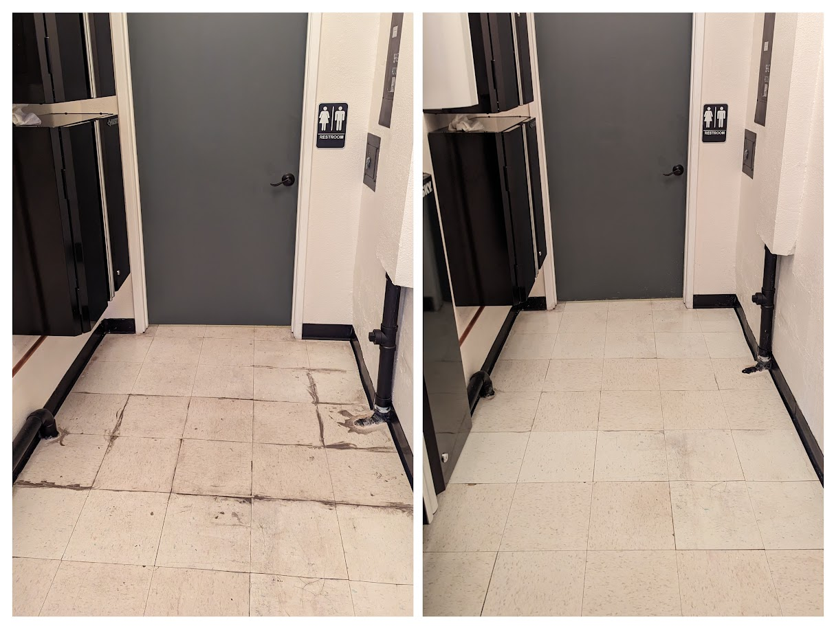

Vct had to be pulled up
$18k on this water damage job from the last 2 weeks
115,920
sometimes better is good enough...
Reactions: Jim Pemberton
115,920
Nah
Tear that crap out
Designer coffee shop that struggles each month to pay the rent to a slumlord.
The hallway floor was that way when they moved in.
It embarrassed them enough to call me but they were not about to pay to replace the landlords floor.
More than good enough.
12,559
