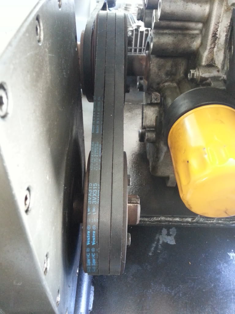

I'm pretty sure this is my third set in 780 hours..
I'm snugging them up to what "feels" right and snugging them up again after a few days of replacement, even using this tool to do the centering/tightening..
Looks good and straight..

Two very different animals. Three sets of belts on your slide-in in 780 hours. It seems that is about par for the course. I read some guy with a Prochem Peak bragging how he could change his belts in less than 30 minutes; he had to do it every 100 hours:madd:. I did change my belts on the Pro 1200 after 7800 hours, not because they needed it, but, well I can't remember the reason.

Two things to improve belt life:
1. Better Cooling - try a radiator fan blowing in
2. Matching only Gates belts, we use the same belts,
and try to match lengths for multiple belt drives.
You should get at least 500 hrs from that 3-belt drive system.
Larry

Running a blower on (3) 3/8" belts is a lot to ask especially considering the heat off the shaft side of that engine can exceed 300 degrees and the length of the belt doesn't help either.
My slide in use to eat EPDM direct drive couplers for lunch till I installed a 12" radiator fan to cool the components.
I would install a cooling fan unless you like changing belts often.

Mike I think 500 to 1000 hrs would be normal. So your not way off but definetely premature. I too always second guess how tight to get my belts. I did just replace my belts on the TNT so will see how long they last.

When I started with my PowerClean I couldn't get 50 hour on a set of belts. I currently have more than 1200 hours on a set with no sign of wear. Heat is the issue and I believe slippage is the biggest cause of heat especially unit with blower heat exchangers. Most of these unit are requiring the belts to do more than they can without slippage. I got rid of the blower heat exchanger and opened up the plumbing. I also run my belts tighter(less than 1/2" deflection) than most other would.

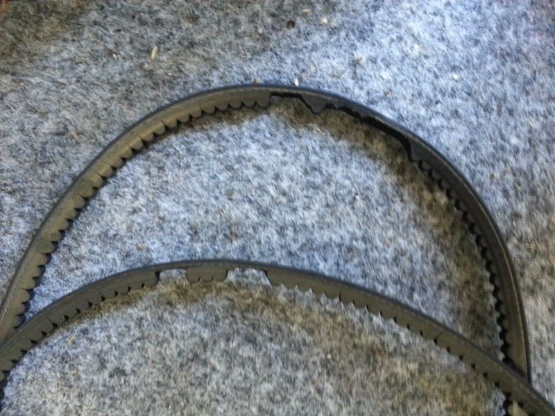

Like Shane, With my Powerclean , slippage was the issue due to the pulleys being too small. I upgraded the pulleys from 5-6 inch to 8-9 inch and haven't changed belts since I did it this last winter. I was changing them every 100- 200 hrs. before. Belts are cheap so it wasn't a big deal, but the pulley on my Nissan engine wore to the point that the belts wouldn't hold any longer. Mike- You should look into the Predator belts if you can get them the correct length. You won't have to worry at all about them ever breaking compared to the tri power belts.

The last thing you want is for a belt to break. Believe me, it makes a helluva mess.

When my 3 belts broke, they disintegrated all over inside my van. Not much left. Thats why I reommend Predator belts.
