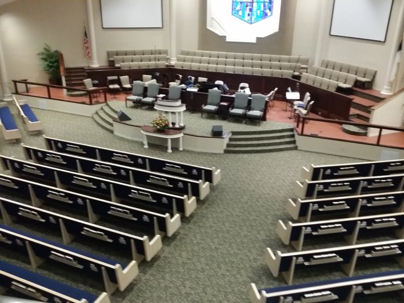

So Im giving a quote to this church that is pretty big. Its 8,850 sq. feet. He wants a quote for getting it done annually and a quote for getting the upholstery cleaned. There are 104 brown chairs 55 long blue pue, 4 mini 4 foot, 4 small 7 foot, 4 medium 11 foot, 26 large 14 foot 14 extra large 16 foot, and 49 steps.
Im not trying to make a killing out one job. I want to price it right to make a profit and get repeat business. The Church is also an school, therefore, if I win the bid, I will have an opportunity to clean auditorium and classrooms. Not to mention children parents that send there children to this private christian school.
Im using an Everest truck mount to get the job done.
How much would you charge for this job? Would you try to sell a maintenance program?

Lets start with what do you expect as a reasonable return on your investment. For ease of calculations lets say you want $150.00 an hour and you can process 1,000 sq/ft an hour. This may be possible with a scrub wand but easily doable for extended periods of time with a Zipper. .15 sq/ft x 1,000 an hour =$150.00
Its easy charge .15 a sq/ft......whoa wait one minute there pardner, .15 isn't going to be very competitive. You'll get some but most likely get passed over by most.
So what can we do to make this work. You can clean faster or you can target less if you are aggressively seeking the work.
1300sq/ft an hour is will allow you to still hit your target of $150.00 and be competitive at .12
1300 x.12 =$156.00
If your target is only $100.00 then you can charge less. I'd caution you on the high side just because of Murphy. Murphy can be slow tech's, setup & tear down, odd ball hours.

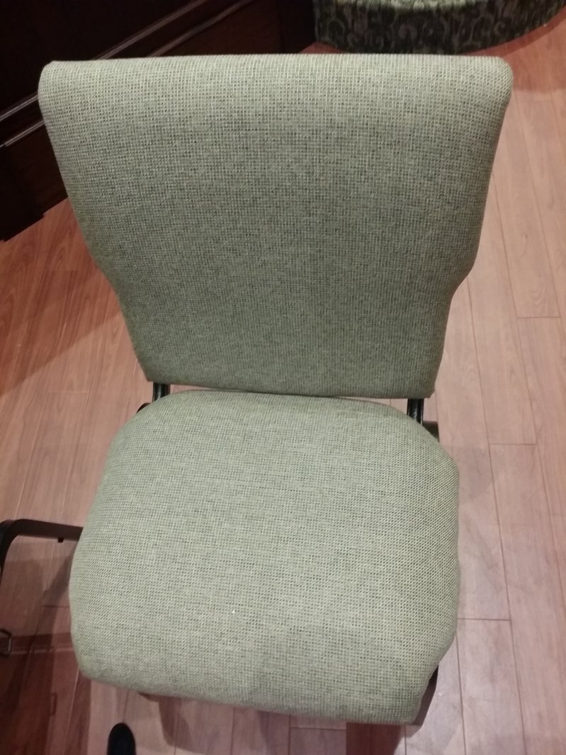

Upholster the same way. Look at each piece and determine how long will it take a technician to process that item. How much do I target hourly, how many can I process in the hour. Divide the number processed into your hourly target number.
Get two upholstery tools, a (3) man crew running on the Everest should make fast work of upholstery. Two tech's cleaning one tech preconditioning and bringing the chairs to the tech's cleaning. He can also trade off with the cleaners to give them a break if they are cleaning for extended periods.

I also try to figure out how much its going to take for my time so like Richard mentioned I try to figure out average square foot an hour. My normal rate is $0.38 a square foot but for churches I take an automatic 20% off and then look if I can still do it cheaper or if I am in the right ballpark.
I find I am doing churches for for about $0.25 a square foot sometimes also, but I do get a bit higher rate for some reason where I am located. And even if someone comes in lower on their price I have been fortunate to receive the account.
On church pews I tend to get $1 per linear foot for the bottom section of the pews and on the backs of the pews around $1 to a dollar fifty per linear foot. We use a glided stair tool with water pressure down to about 350 psi and can get by with cleaning most of the pew that way. Then we follow up with an upholstery tool for any other detail work needed.
For those upholstered chairs I see in the picture we get anywhere from $5 to $10 per chair. For us it depends a little bit on the soil level so we can figure how much time we will have into those and then try to price accordingly.
